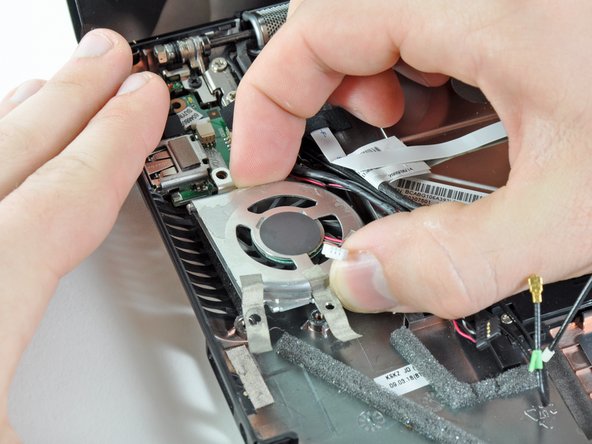

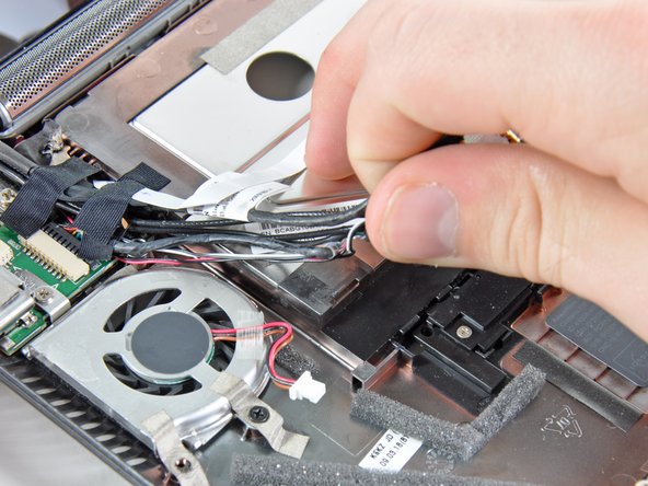

  40. HP Mini 1000 USB & Power Board Replacement, Fan: crwdns2935265:040crwdnd2935265:01crwdnd2935265:01crwdne2935265:0
    • If present, remove the piece of black cloth tape holding the bundle of cables to the top of the fan.
  41. HP Mini 1000 USB & Power Board Replacement: crwdns2935265:041crwdnd2935265:01crwdnd2935265:02crwdne2935265:0 HP Mini 1000 USB & Power Board Replacement: crwdns2935265:041crwdnd2935265:02crwdnd2935265:02crwdne2935265:0
    • Carefully untangle the fan cable from the bundle of cables leading to the display.
  42. HP Mini 1000 USB & Power Board Replacement: crwdns2935265:042crwdnd2935265:01crwdnd2935265:02crwdne2935265:0 HP Mini 1000 USB & Power Board Replacement: crwdns2935265:042crwdnd2935265:02crwdnd2935265:02crwdne2935265:0
    • Remove the following two screws:
    • One 3 mm Phillips screw
    • One 4.5 mm Phillips screw
    • Remove the fan from the lower case.
    • If you are replacing the fan, transfer the pieces of EMI tape to your new fan before installation.

    • If present, remove the two pieces of tape covering the cables routed near the USB and power board.
  44. HP Mini 1000 USB & Power Board Replacement: crwdns2935265:044crwdnd2935265:01crwdnd2935265:01crwdne2935265:0
    • Use a pair of tweezers to pull the internal display switch cable straight away from its socket on the USB and power board.
  45. HP Mini 1000 USB & Power Board Replacement: crwdns2935265:045crwdnd2935265:01crwdnd2935265:01crwdne2935265:0
    • Peel and de-route the SIM card ribbon cable from its channel on top of the underside of the battery compartment.
    • The SIM card ribbon cable is still connected to the USB and power board. Do not completely remove it yet.
  46. HP Mini 1000 USB & Power Board Replacement: crwdns2935265:046crwdnd2935265:01crwdnd2935265:01crwdne2935265:0

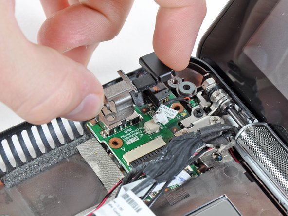

    • Remove the single 3 mm Phillips screw that secures the USB and power board as well as the DC jack bracket to the lower case.
  47. HP Mini 1000 USB & Power Board Replacement: crwdns2935265:047crwdnd2935265:01crwdnd2935265:02crwdne2935265:0 HP Mini 1000 USB & Power Board Replacement: crwdns2935265:047crwdnd2935265:02crwdnd2935265:02crwdne2935265:0
    • Lift the DC jack bracket up off the USB and power board.
  48. HP Mini 1000 USB & Power Board Replacement: crwdns2935265:048crwdnd2935265:01crwdnd2935265:02crwdne2935265:0 HP Mini 1000 USB & Power Board Replacement: crwdns2935265:048crwdnd2935265:02crwdnd2935265:02crwdne2935265:0
    • Grasp the USB and power board from its left edge, nearest the ports side.
    • Remove the USB and power board straight away from its recess in the lower case, minding any cables that may get tangled.

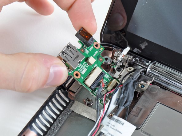

  49. HP Mini 1000 USB & Power Board Replacement, USB & Power Board: crwdns2935265:049crwdnd2935265:01crwdnd2935265:02crwdne2935265:0 HP Mini 1000 USB & Power Board Replacement, USB & Power Board: crwdns2935265:049crwdnd2935265:02crwdnd2935265:02crwdne2935265:0

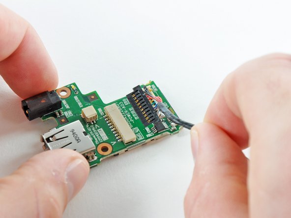

    • Use your fingernail or the flat end of a spudger to flip up the retaining flap on the SIM card cable ZIF socket.
    • Be sure you are prying up on the retaining flap, not the socket itself.
    • Pull the SIM card ribbon cable out of its socket.

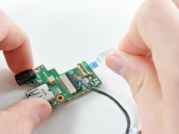

  50. HP Mini 1000 USB & Power Board Replacement: crwdns2935265:050crwdnd2935265:01crwdnd2935265:02crwdne2935265:0 HP Mini 1000 USB & Power Board Replacement: crwdns2935265:050crwdnd2935265:02crwdnd2935265:02crwdne2935265:0
    • Use the flat end of a spudger to gently push the power cable from its socket.
    • Be sure you are pushing on the cable, not the socket itself.
    • It is recommended to push the connector from both sides in a side-by-side rocking motion to dislodge it from its socket.
    • Pull the power ribbon cable out of its socket.
  51. HP Mini 1000 USB & Power Board Replacement: crwdns2935265:051crwdnd2935265:01crwdnd2935265:01crwdne2935265:0
    • USB and power board remains.
