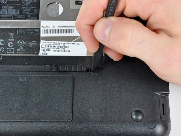

      • Before proceeding, slide the right battery release latch to the unlocked position nearest the center of the computer.
      • Use the tip of a spudger to slide the RAM compartment cover release latch away from the center of the computer.
      • At this point, the edge of the RAM compartment cover nearest the battery compartment should pop up from the lower case.

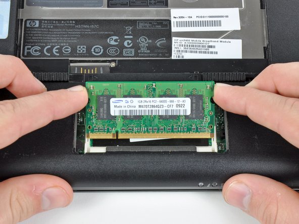

    3. HP Mini 1000 RAM Replacement: crwdns2935265:05crwdnd2935265:01crwdnd2935265:02crwdne2935265:0 HP Mini 1000 RAM Replacement: crwdns2935265:05crwdnd2935265:02crwdnd2935265:02crwdne2935265:0
      • Use your fingers to simultaneously pull both RAM retaining arms away from the center of the RAM chip.
      • The RAM chip should pop up slightly from its socket.
      • Pull the RAM chip out of its socket and remove it from the Mini 1000.
