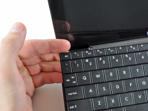

  4. HP Mini 1000 Motherboard Replacement: crwdns2935265:04crwdnd2935265:01crwdnd2935265:03crwdne2935265:0 HP Mini 1000 Motherboard Replacement: crwdns2935265:04crwdnd2935265:02crwdnd2935265:03crwdne2935265:0 HP Mini 1000 Motherboard Replacement: crwdns2935265:04crwdnd2935265:03crwdnd2935265:03crwdne2935265:0
    • To facilitate the removal of the keyboard, it is recommended to push the keyboard outwards with one hand through the opening (highlighted in the third picture) located on the backside of the Mini 1000.
    • While pushing through the opening with one hand, grasp the left upper edge with the other hand and slightly pull the keyboard towards you.
    • Once an opening has been established, grasp the keyboard and slowly lift it upwards along the upper perimeter of the top edge.

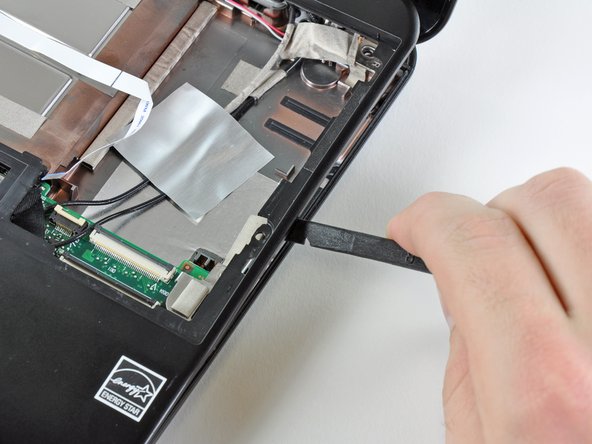

  14. HP Mini 1000 Motherboard Replacement: crwdns2935265:014crwdnd2935265:01crwdnd2935265:02crwdne2935265:0 HP Mini 1000 Motherboard Replacement: crwdns2935265:014crwdnd2935265:02crwdnd2935265:02crwdne2935265:0
    • Wedge the flat end of a spudger in between the upper case and lower case near the bottom right corner of the display.
    • Carefully pry and rock the spudger upwards to create a small gap between the upper case and lower case.
    • Continue the previously described motion along the right edge of the upper case to release the clips securing the upper case to the lower case.

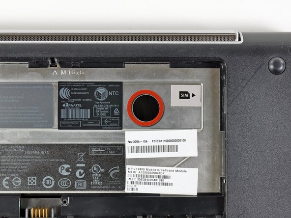

  25. HP Mini 1000 Motherboard Replacement, WWAN Board: crwdns2935265:025crwdnd2935265:01crwdnd2935265:01crwdne2935265:0
    • If present, carefully peel the piece of tape covering the WWAN board.
  26. HP Mini 1000 Motherboard Replacement: crwdns2935265:026crwdnd2935265:01crwdnd2935265:02crwdne2935265:0 HP Mini 1000 Motherboard Replacement: crwdns2935265:026crwdnd2935265:02crwdnd2935265:02crwdne2935265:0
    • Pry the WWAN antenna connectors (2 total) up off the WWAN board.
    • During reassembly, remember to correctly connect the antenna cables to their respective terminals. The red labeled antenna is connected to the "MAIN" terminal and the blue labeled antenna is connected to the "AUX" terminal.

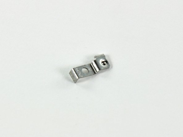

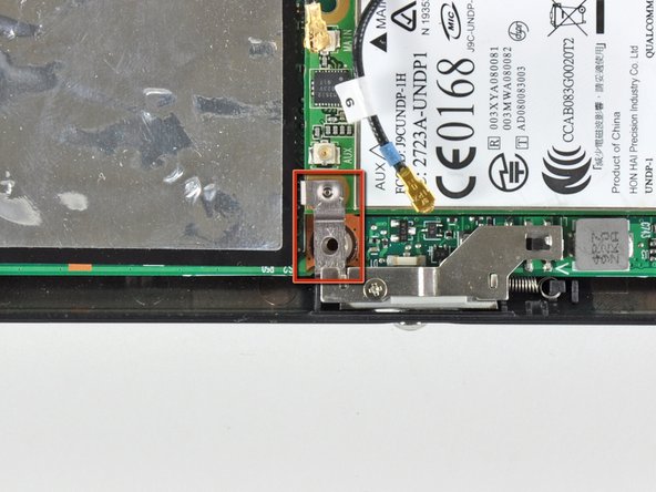

  27. HP Mini 1000 Motherboard Replacement: crwdns2935265:027crwdnd2935265:01crwdnd2935265:03crwdne2935265:0 HP Mini 1000 Motherboard Replacement: crwdns2935265:027crwdnd2935265:02crwdnd2935265:03crwdne2935265:0 HP Mini 1000 Motherboard Replacement: crwdns2935265:027crwdnd2935265:03crwdnd2935265:03crwdne2935265:0
    • Remove the single 3 mm Phillips screw securing the WWAN metal bracket and WWAN board to the motherboard.
    • During reassembly, before securing the WWAN board to the upper case, be sure the metal bracket is correctly placed (as highlighted in the second picture).
    • Be cautious of the metal bracket's displacement. It can easily become lost during disassembly.

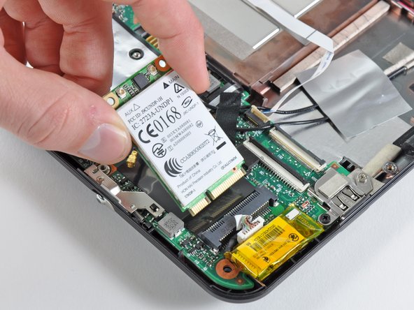

  28. HP Mini 1000 Motherboard Replacement: crwdns2935265:028crwdnd2935265:01crwdnd2935265:02crwdne2935265:0 HP Mini 1000 Motherboard Replacement: crwdns2935265:028crwdnd2935265:02crwdnd2935265:02crwdne2935265:0
    • Upon removing the Phillips screw that secures the WWAN board to the motherboard, the WWAN board should pop up from its left side.
    • Grasp the WWAN board and pull it straight out of its socket on the motherboard.

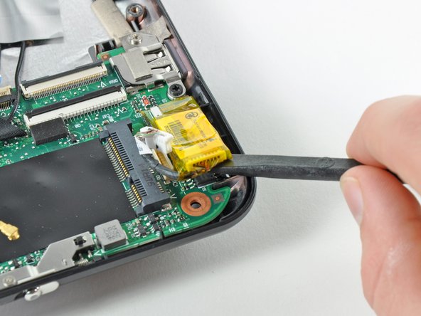

  29. HP Mini 1000 Motherboard Replacement, Bluetooth Board: crwdns2935265:029crwdnd2935265:01crwdnd2935265:02crwdne2935265:0 HP Mini 1000 Motherboard Replacement, Bluetooth Board: crwdns2935265:029crwdnd2935265:02crwdnd2935265:02crwdne2935265:0
    • Use the flat end of a spudger to lift the Bluetooth cable connector out of its socket on the motherboard.
    • Carefully pry the Bluetooth board off the motherboard and remove it from the Mini 1000.

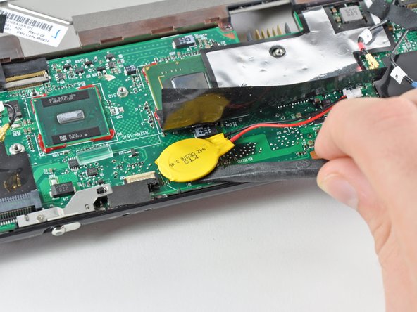

  30. HP Mini 1000 Motherboard Replacement, PRAM Battery: crwdns2935265:030crwdnd2935265:01crwdnd2935265:01crwdne2935265:0
    • If present, carefully peel back the piece of black film attached to the heat sink to reveal the PRAM battery and its cable.
  31. HP Mini 1000 Motherboard Replacement: crwdns2935265:031crwdnd2935265:01crwdnd2935265:02crwdne2935265:0 HP Mini 1000 Motherboard Replacement: crwdns2935265:031crwdnd2935265:02crwdnd2935265:02crwdne2935265:0
    • Use a pair of tweezers to pull the PRAM battery connector out of its socket on the motherboard.
    • Pull the connector parallel to the face of the motherboard toward the fan side of the computer.
    • Use the flat end of a spudger to pry the PRAM battery off the adhesive securing it to the motherboard.
    • Remove the PRAM battery.

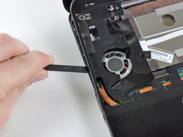

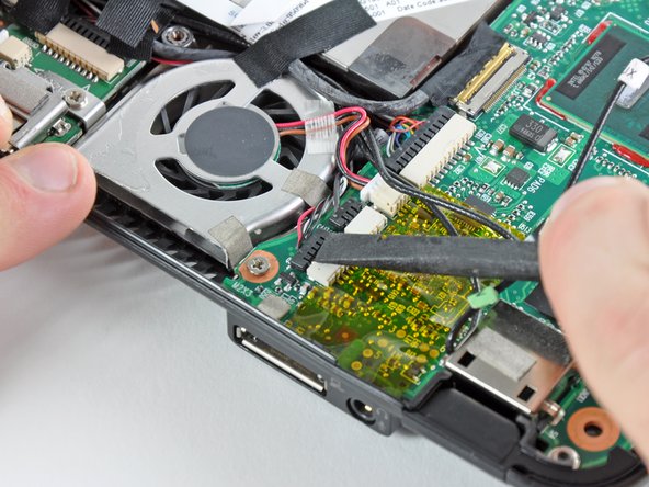

  34. HP Mini 1000 Motherboard Replacement: crwdns2935265:034crwdnd2935265:01crwdnd2935265:02crwdne2935265:0 HP Mini 1000 Motherboard Replacement: crwdns2935265:034crwdnd2935265:02crwdnd2935265:02crwdne2935265:0
    • Use the flat end of a spudger or your fingers to disconnect the following cables:
    • Speaker cable
    • Microphone cable
    • Fan cable
    • Power cable
    • Display data cable
    • Do not lift the connectors up as you disconnect them from the motherboard. Push the connectors out of their sockets parallel to the face of the logic board toward the display assembly. Use extra care when disconnecting the display data cable, as its connector and socket are fragile.

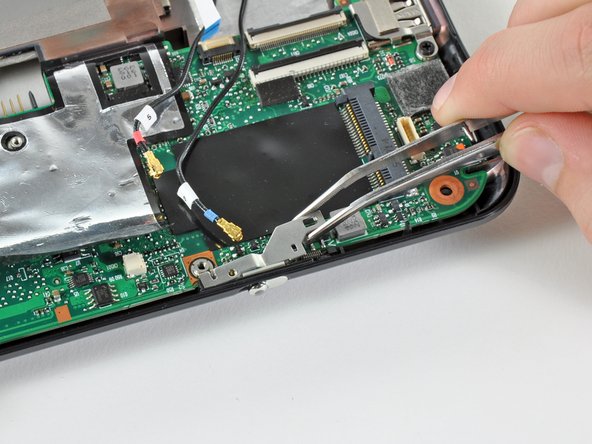

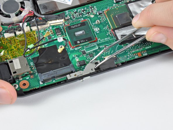

  35. HP Mini 1000 Motherboard Replacement: crwdns2935265:035crwdnd2935265:01crwdnd2935265:02crwdne2935265:0 HP Mini 1000 Motherboard Replacement: crwdns2935265:035crwdnd2935265:02crwdnd2935265:02crwdne2935265:0
    • Remove the 2.5 mm Phillips screw securing the power switch lever to the lower case.
    • Use a pair of tweezers or your fingers to lift the power switch lever out of the Mini 1000.
  36. HP Mini 1000 Motherboard Replacement: crwdns2935265:036crwdnd2935265:01crwdnd2935265:02crwdne2935265:0 HP Mini 1000 Motherboard Replacement: crwdns2935265:036crwdnd2935265:02crwdnd2935265:02crwdne2935265:0
    • Remove the 2.5 mm Phillips screw securing the wireless on/off switch lever to the lower case.
    • Use tweezers or your fingers to remove the wireless on/off switch lever from the Mini 1000.

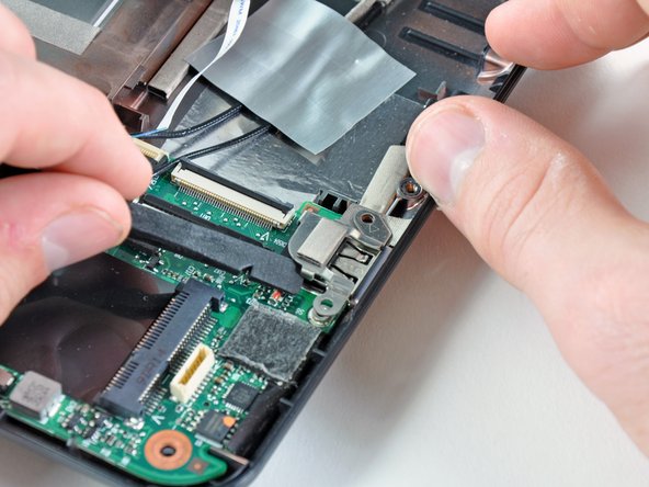

  37. HP Mini 1000 Motherboard Replacement: crwdns2935265:037crwdnd2935265:01crwdnd2935265:02crwdne2935265:0 HP Mini 1000 Motherboard Replacement: crwdns2935265:037crwdnd2935265:02crwdnd2935265:02crwdne2935265:0
    • Remove the two 3 mm Phillips screws securing the USB bracket to the lower case.
    • Pry up the USB bracket and remove it from the motherboard.

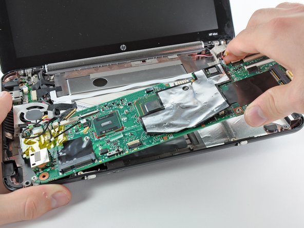

  38. HP Mini 1000 Motherboard Replacement: crwdns2935265:038crwdnd2935265:01crwdnd2935265:01crwdne2935265:0
    • Remove the single 4.5 mm Phillips screw securing the motherboard to the lower case near the fan.
  39. HP Mini 1000 Motherboard Replacement: crwdns2935265:039crwdnd2935265:01crwdnd2935265:02crwdne2935265:0 HP Mini 1000 Motherboard Replacement: crwdns2935265:039crwdnd2935265:02crwdnd2935265:02crwdne2935265:0
    • Carefully lift the motherboard from its right edge and remove it from the lower case, minding any cables that may get caught.

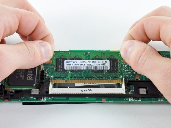

  40. HP Mini 1000 Motherboard Replacement, Motherboard: crwdns2935265:040crwdnd2935265:01crwdnd2935265:02crwdne2935265:0 HP Mini 1000 Motherboard Replacement, Motherboard: crwdns2935265:040crwdnd2935265:02crwdnd2935265:02crwdne2935265:0
    • Use your fingers to simultaneously pull both RAM retaining arms away from the center of the RAM chip.
    • The RAM chip should pop up slightly from its socket.
    • Pull the RAM chip out of its socket and remove it from the Mini 1000.
    • Motherboard remains.
