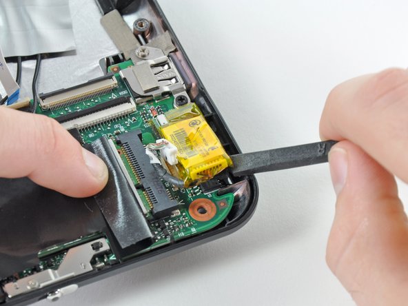

  18. HP Mini 1000 Bluetooth Board Replacement, Bluetooth Board: crwdns2935265:018crwdnd2935265:01crwdnd2935265:01crwdne2935265:0
    • If present, slightly peel back the large piece of black adhesive film covering the connector on the Bluetooth cable.
    • It is not necessary to completely remove the piece of film from the computer.
  19. HP Mini 1000 Bluetooth Board Replacement: crwdns2935265:019crwdnd2935265:01crwdnd2935265:02crwdne2935265:0 HP Mini 1000 Bluetooth Board Replacement: crwdns2935265:019crwdnd2935265:02crwdnd2935265:02crwdne2935265:0
    • While holding the film out of the way, use the flat end of a spudger to carefully lift the Bluetooth cable connector out of its socket on the motherboard.
    • Gently pry the Bluetooth board off the motherboard and remove it from the Mini 1000.
