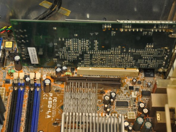

  3. HP Media Center 876x Video Card Replacement, Video Card: crwdns2935265:03crwdnd2935265:01crwdnd2935265:01crwdne2935265:0
    • Identify the video card (the green card nearest to the fan casing in the bottom left hand corner of the tower).
  4. HP Media Center 876x Video Card Replacement: crwdns2935265:04crwdnd2935265:01crwdnd2935265:01crwdne2935265:0
    • Using a Phillips #0 screwdriver, remove the single 6 mm screw fastening the video card to its mount.
  5. HP Media Center 876x Video Card Replacement: crwdns2935265:05crwdnd2935265:01crwdnd2935265:02crwdne2935265:0 HP Media Center 876x Video Card Replacement: crwdns2935265:05crwdnd2935265:02crwdnd2935265:02crwdne2935265:0
    • Pull the video card vertically out of its port.
