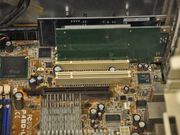

  3. HP Media Center 876x TV Tuner Card Replacement, TV Tuner Card: crwdns2935265:03crwdnd2935265:01crwdnd2935265:02crwdne2935265:0 HP Media Center 876x TV Tuner Card Replacement, TV Tuner Card: crwdns2935265:03crwdnd2935265:02crwdnd2935265:02crwdne2935265:0
    • Identify the TV tuner card (distal from the cooling fan, in the lower-left corner of the tower).
    • Using a #0 Phillips head screwdriver, remove the one (6 mm) screw fastening the TV tuner card into its slot.
  4. HP Media Center 876x TV Tuner Card Replacement: crwdns2935265:04crwdnd2935265:01crwdnd2935265:02crwdne2935265:0 HP Media Center 876x TV Tuner Card Replacement: crwdns2935265:04crwdnd2935265:02crwdnd2935265:02crwdne2935265:0
    • Gently pull the card vertically out of its port.
