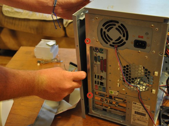

  1. HP Media Center 876x Front Cover Replacement, Side Panel: crwdns2935265:01crwdnd2935265:01crwdnd2935265:02crwdne2935265:0 HP Media Center 876x Front Cover Replacement, Side Panel: crwdns2935265:01crwdnd2935265:02crwdnd2935265:02crwdne2935265:0
    • Remove the two (9 mm) hand screws on the back panel.
  2. HP Media Center 876x Front Cover Replacement: crwdns2935265:02crwdnd2935265:01crwdnd2935265:03crwdne2935265:0 HP Media Center 876x Front Cover Replacement: crwdns2935265:02crwdnd2935265:02crwdnd2935265:03crwdne2935265:0 HP Media Center 876x Front Cover Replacement: crwdns2935265:02crwdnd2935265:03crwdnd2935265:03crwdne2935265:0
    • Place the tower on its side.
    • Slide the side panel horizontally to detach, and pull upward to remove.
  3. HP Media Center 876x Front Cover Replacement, Front Cover: crwdns2935265:03crwdnd2935265:01crwdnd2935265:02crwdne2935265:0 HP Media Center 876x Front Cover Replacement, Front Cover: crwdns2935265:03crwdnd2935265:02crwdnd2935265:02crwdne2935265:0
    • Orient the tower vertically.
    • Using the #0 Phillips head screwdriver, unscrew and remove the two (5 mm) screws that fasten the remaining side panel to the tower.
    • Slide the side panel out of its notches, and pull it gently off of the tower.

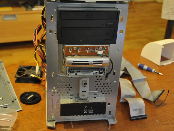

  4. HP Media Center 876x Front Cover Replacement: crwdns2935265:04crwdnd2935265:01crwdnd2935265:01crwdne2935265:0
    • Gently move the tower so that it is in the horizontal orientation.
    • Press down the black tabs (proximal to you) that fasten the front panel to the tower.
    • Press down on the distal, black tabs (symmetric with respect to the previous tabs).
    • Pull front panel forward slightly.
  5. HP Media Center 876x Front Cover Replacement: crwdns2935265:05crwdnd2935265:01crwdnd2935265:02crwdne2935265:0 HP Media Center 876x Front Cover Replacement: crwdns2935265:05crwdnd2935265:02crwdnd2935265:02crwdne2935265:0
    • The front panel will come off in a hinge-like fashion, exposing the drives underneath.
