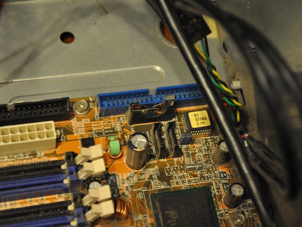

  3. HP Media Center 876x CMOS Battery Replacement, CMOS Battery: crwdns2935265:03crwdnd2935265:01crwdnd2935265:01crwdne2935265:0
    • Identify the CMOS battery.

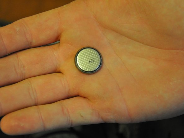

  4. HP Media Center 876x CMOS Battery Replacement: crwdns2935265:04crwdnd2935265:01crwdnd2935265:03crwdne2935265:0 HP Media Center 876x CMOS Battery Replacement: crwdns2935265:04crwdnd2935265:02crwdnd2935265:03crwdne2935265:0 HP Media Center 876x CMOS Battery Replacement: crwdns2935265:04crwdnd2935265:03crwdnd2935265:03crwdne2935265:0
    • Pull battery, in a rolling motion, out of its slot.
