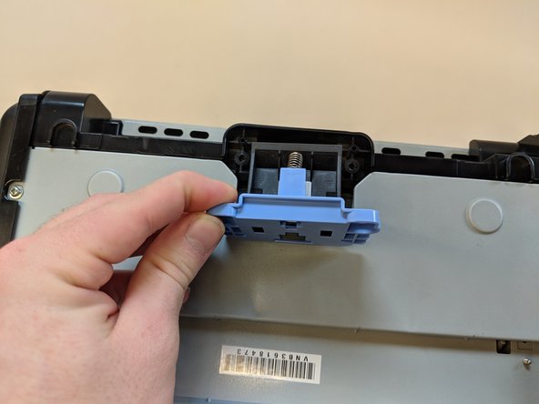

    3. HP LaserJet P1102w Printer Feed Spring Replacement: crwdns2935265:03crwdnd2935265:01crwdnd2935265:03crwdne2935265:0 HP LaserJet P1102w Printer Feed Spring Replacement: crwdns2935265:03crwdnd2935265:02crwdnd2935265:03crwdne2935265:0 HP LaserJet P1102w Printer Feed Spring Replacement: crwdns2935265:03crwdnd2935265:03crwdnd2935265:03crwdne2935265:0
      • Now with both screws out, remove the paper feeding housing from the printer.

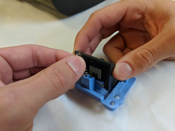

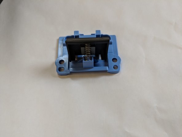

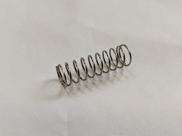

    4. HP LaserJet P1102w Printer Feed Spring Replacement: crwdns2935265:04crwdnd2935265:01crwdnd2935265:03crwdne2935265:0 HP LaserJet P1102w Printer Feed Spring Replacement: crwdns2935265:04crwdnd2935265:02crwdnd2935265:03crwdne2935265:0 HP LaserJet P1102w Printer Feed Spring Replacement: crwdns2935265:04crwdnd2935265:03crwdnd2935265:03crwdne2935265:0
      • Compress and remove spring from paper feed housing.
