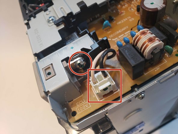

    1. HP LaserJet P1102w Power Plug Replacement, Power Plug: crwdns2935265:08crwdnd2935265:01crwdnd2935265:02crwdne2935265:0 HP LaserJet P1102w Power Plug Replacement, Power Plug: crwdns2935265:08crwdnd2935265:02crwdnd2935265:02crwdne2935265:0
      • The power plug will be held together with one Phillips screw 7mm and wire connection.
    2. HP LaserJet P1102w Power Plug Replacement: crwdns2935265:09crwdnd2935265:01crwdnd2935265:02crwdne2935265:0 HP LaserJet P1102w Power Plug Replacement: crwdns2935265:09crwdnd2935265:02crwdnd2935265:02crwdne2935265:0
      • Unplug wire connector and unscrew the Phillips 7mm screw with #1 Phillips screw driver.
    3. HP LaserJet P1102w Power Plug Replacement: crwdns2935265:010crwdnd2935265:01crwdnd2935265:03crwdne2935265:0 HP LaserJet P1102w Power Plug Replacement: crwdns2935265:010crwdnd2935265:02crwdnd2935265:03crwdne2935265:0 HP LaserJet P1102w Power Plug Replacement: crwdns2935265:010crwdnd2935265:03crwdnd2935265:03crwdne2935265:0
      • Apply pressure using spudger on top of the power plug to release it from metal housing. While doing that pull the power plug out.
