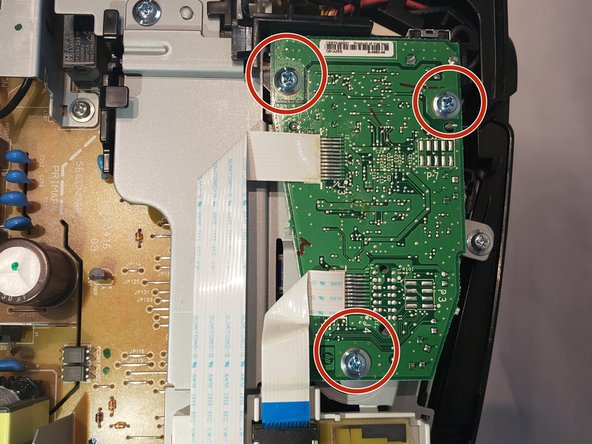

  8. HP LaserJet P1102w Motherboard Replacement, Motherboard: crwdns2935265:08crwdnd2935265:01crwdnd2935265:03crwdne2935265:0 HP LaserJet P1102w Motherboard Replacement, Motherboard: crwdns2935265:08crwdnd2935265:02crwdnd2935265:03crwdne2935265:0 HP LaserJet P1102w Motherboard Replacement, Motherboard: crwdns2935265:08crwdnd2935265:03crwdnd2935265:03crwdne2935265:0
    • Remove three #1 Phillips 6mm screws with the #1 Phillips screwdriver.

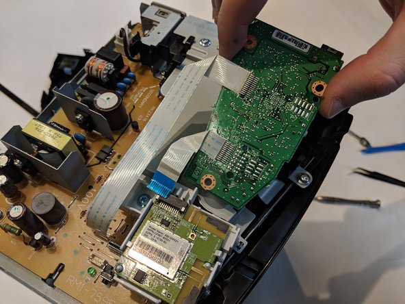

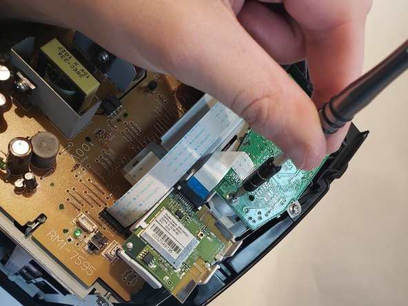

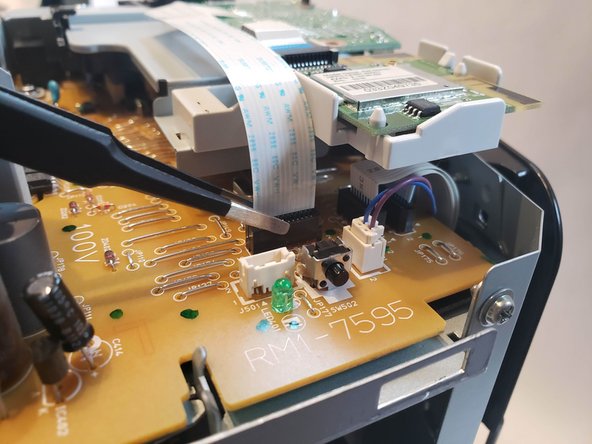

  9. HP LaserJet P1102w Motherboard Replacement: crwdns2935265:09crwdnd2935265:01crwdnd2935265:03crwdne2935265:0 HP LaserJet P1102w Motherboard Replacement: crwdns2935265:09crwdnd2935265:02crwdnd2935265:03crwdne2935265:0 HP LaserJet P1102w Motherboard Replacement: crwdns2935265:09crwdnd2935265:03crwdnd2935265:03crwdne2935265:0
    • Using a pair of blunt nose tweezers, disconnect both ribbon wires.
    • With both ribbon wires removed we can lift the motherboard out of its housing.
    • There is a little black notch holding the motherboard down by the thumb in the final picture.
    • Be careful pulling, as ribbon wires are very fragile.
