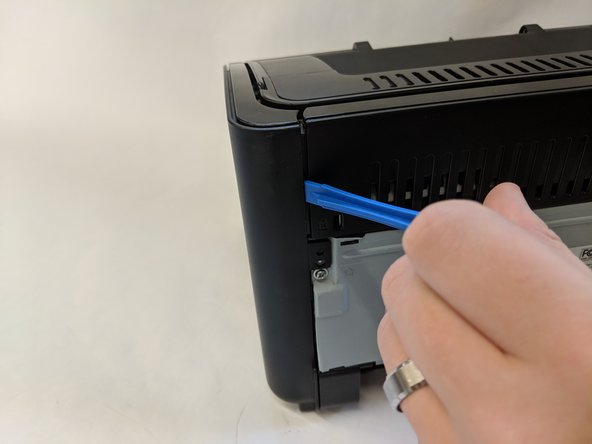

    • Flip printer on it's back. Using the plastic spudger, pry off front panel. There will be two main points to focus as shown.
    • Pry carefully to not break any plastic.

    • Now that the pry points are free lift up the front panel.

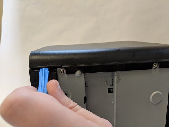

    • Use the plastic spudger to remove the side panel. There are three main prying points as shown.
  7. HP LaserJet P1102w Drive Belt Replacement: crwdns2935265:07crwdnd2935265:01crwdnd2935265:02crwdne2935265:0 HP LaserJet P1102w Drive Belt Replacement: crwdns2935265:07crwdnd2935265:02crwdnd2935265:02crwdne2935265:0
    • With all pry points free, remove the side panel.

the tight side panel clips make this a difficult procedure, so take care both disassembling and assembling, for example make sure the power button is aligned with the level components behind before you push to clip the front home, as misalignment can break or dislocate internal parts.
