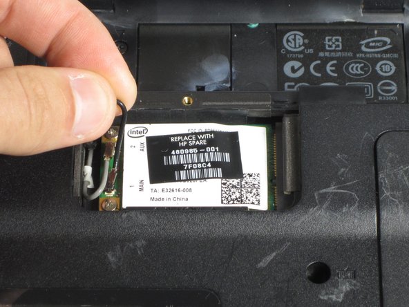

  5. HP HDX 16-1160US Wifi Card Replacement: crwdns2935265:05crwdnd2935265:01crwdnd2935265:02crwdne2935265:0 HP HDX 16-1160US Wifi Card Replacement: crwdns2935265:05crwdnd2935265:02crwdnd2935265:02crwdne2935265:0
    • Remove the gray and black wires by gently pulling up on them so that they "unsnap" from the Wi-Fi card.
