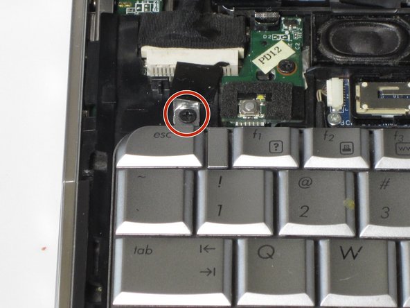

  4. HP HDX 16-1160US DVD Drive Replacement, Keyboard: crwdns2935265:04crwdnd2935265:01crwdnd2935265:01crwdne2935265:0
    • Remove the three 4mm screws using Phillips #1 screw driver.
    • Remove the four 6mm screws using Phillips #1 screw driver.
    • Remove the two 3mm screws using Phillips #1 screw driver.

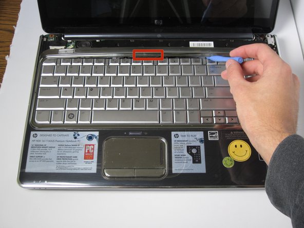

  6. HP HDX 16-1160US DVD Drive Replacement: crwdns2935265:06crwdnd2935265:01crwdnd2935265:03crwdne2935265:0 HP HDX 16-1160US DVD Drive Replacement: crwdns2935265:06crwdnd2935265:02crwdnd2935265:03crwdne2935265:0 HP HDX 16-1160US DVD Drive Replacement: crwdns2935265:06crwdnd2935265:03crwdnd2935265:03crwdne2935265:0
    • Use the plastic opener to pry up the chrome keyboard cover from the lab top itself. Carefully work around the edges by prying each snap individually.
    • Remove the chrome keyboard cover.
    • Be careful not to pull the chrome cover completely off because there is a black strip connecting it to the laptop itself.

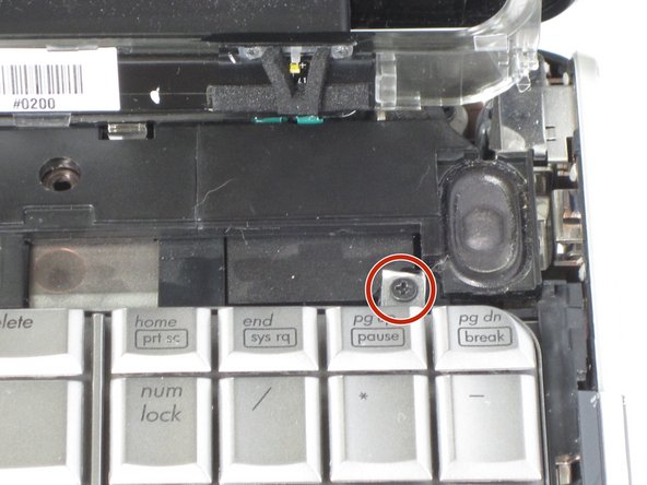

  7. HP HDX 16-1160US DVD Drive Replacement: crwdns2935265:07crwdnd2935265:01crwdnd2935265:03crwdne2935265:0 HP HDX 16-1160US DVD Drive Replacement: crwdns2935265:07crwdnd2935265:02crwdnd2935265:03crwdne2935265:0 HP HDX 16-1160US DVD Drive Replacement: crwdns2935265:07crwdnd2935265:03crwdnd2935265:03crwdne2935265:0
    • Locate and remove the two 4mm screws with the Phillips #1 screw driver.

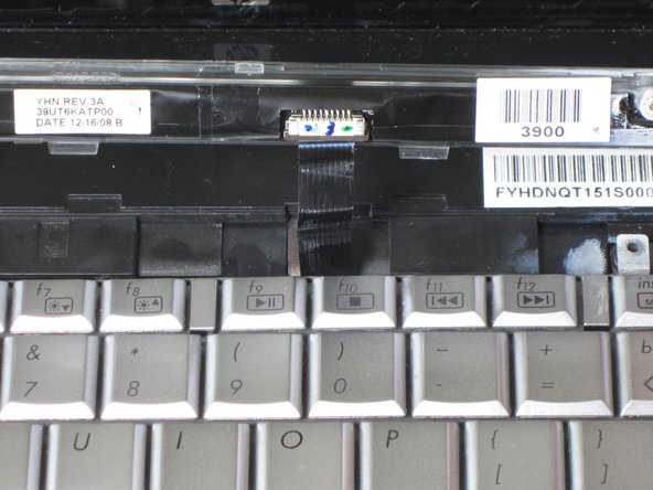

  8. HP HDX 16-1160US DVD Drive Replacement: crwdns2935265:08crwdnd2935265:01crwdnd2935265:02crwdne2935265:0 HP HDX 16-1160US DVD Drive Replacement: crwdns2935265:08crwdnd2935265:02crwdnd2935265:02crwdne2935265:0
    • Using your hands, pull the keyboard out.
    • Do not pull completely off because there is a grey strip connecting it to the laptop itself.

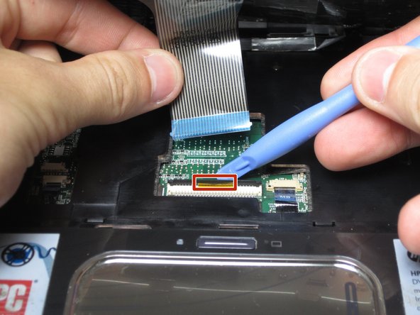

  9. HP HDX 16-1160US DVD Drive Replacement: crwdns2935265:09crwdnd2935265:01crwdnd2935265:02crwdne2935265:0 HP HDX 16-1160US DVD Drive Replacement: crwdns2935265:09crwdnd2935265:02crwdnd2935265:02crwdne2935265:0
    • Lift the black tab using the plastic opening tool.
    • Gently pull the grey strip out, horizontally way from you. This will release the keyboard from the computer.
