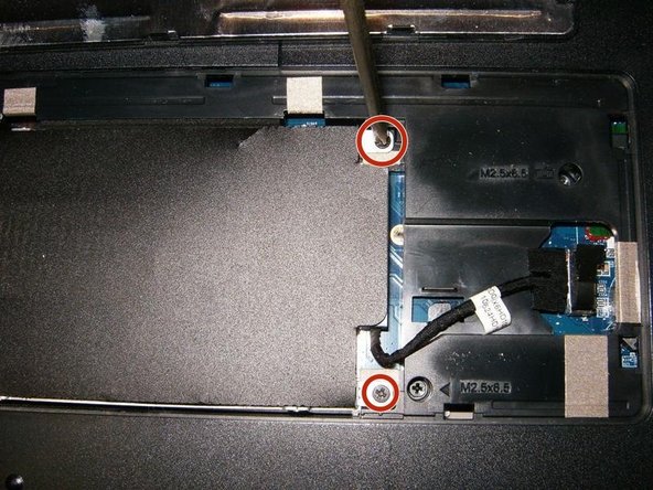

  3. HP G72 Hard Drive Replacement: crwdns2935265:03crwdnd2935265:01crwdnd2935265:03crwdne2935265:0 HP G72 Hard Drive Replacement: crwdns2935265:03crwdnd2935265:02crwdnd2935265:03crwdne2935265:0 HP G72 Hard Drive Replacement: crwdns2935265:03crwdnd2935265:03crwdnd2935265:03crwdne2935265:0
    • Remove the cover
    • Remove the four Phillips M2.5x5.0 screws
    • Disconnect the hard drive cable from the system board.

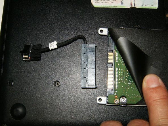

  4. HP G72 Hard Drive Replacement: crwdns2935265:04crwdnd2935265:01crwdnd2935265:03crwdne2935265:0 HP G72 Hard Drive Replacement: crwdns2935265:04crwdnd2935265:02crwdnd2935265:03crwdne2935265:0 HP G72 Hard Drive Replacement: crwdns2935265:04crwdnd2935265:03crwdnd2935265:03crwdne2935265:0
    • Remove the hard drive from the hard drive bay
    • Remove the hard drive cable from the drive.
    • Remove the four (two on either side) Phillips M3.0×4.0 screws that secure the hard drive bracket to the hard drive
