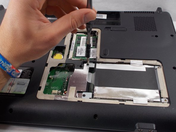

  2. HP G71t-400 Hard Drive Replacement: crwdns2935265:02crwdnd2935265:01crwdnd2935265:03crwdne2935265:0 HP G71t-400 Hard Drive Replacement: crwdns2935265:02crwdnd2935265:02crwdnd2935265:03crwdne2935265:0 HP G71t-400 Hard Drive Replacement: crwdns2935265:02crwdnd2935265:03crwdnd2935265:03crwdne2935265:0
    • Unscrew the 4 circled screws using the PH1 screwdriver to release the cover plate. Remove the screws and set aside.
    • Lift and remove the cover plate to expose the disk drive. Set aside by the screws.

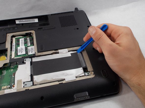

  3. HP G71t-400 Hard Drive Replacement: crwdns2935265:03crwdnd2935265:01crwdnd2935265:03crwdne2935265:0 HP G71t-400 Hard Drive Replacement: crwdns2935265:03crwdnd2935265:02crwdnd2935265:03crwdne2935265:0 HP G71t-400 Hard Drive Replacement: crwdns2935265:03crwdnd2935265:03crwdnd2935265:03crwdne2935265:0
    • Unscrew and remove the 2 circled screws. Set these screws aside, but keep them separate from the cover plate screws.
    • Before touching the disk drive make sure to follow the precautions for handling electrostatic sensitive devices. This will help ensure you do not damage the disk drive and lose your data.
    • After following the precautions, slide the disk drive over so that it disconnects from the disk drive port. An opening tool can be used to help with this but the tool cannot be made of metal or conductive materials
  4. HP G71t-400 Hard Drive Replacement: crwdns2935265:04crwdnd2935265:01crwdnd2935265:01crwdne2935265:0
    • Carefully lift and remove the disk drive keeping in mind the port.
