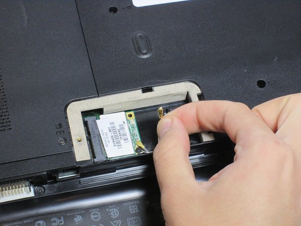

  3. HP G71t-300 Wi-Fi Card Replacement: crwdns2935265:03crwdnd2935265:01crwdnd2935265:01crwdne2935265:0
    • Pull off the bottom cover to reveal the Wi-Fi card.

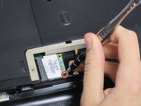

  4. HP G71t-300 Wi-Fi Card Replacement: crwdns2935265:04crwdnd2935265:01crwdnd2935265:03crwdne2935265:0 HP G71t-300 Wi-Fi Card Replacement: crwdns2935265:04crwdnd2935265:02crwdnd2935265:03crwdne2935265:0 HP G71t-300 Wi-Fi Card Replacement: crwdns2935265:04crwdnd2935265:03crwdnd2935265:03crwdne2935265:0
    • Gently remove the 2 cables clips to avoid damage.
    • Remove the 3mm screw holding the Wi-Fi module using a Phillips #0 screwdriver.

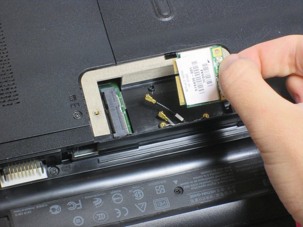

  5. HP G71t-300 Wi-Fi Card Replacement: crwdns2935265:05crwdnd2935265:01crwdnd2935265:02crwdne2935265:0 HP G71t-300 Wi-Fi Card Replacement: crwdns2935265:05crwdnd2935265:02crwdnd2935265:02crwdne2935265:0
    • Gently pull the module out of the slot.
