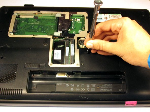

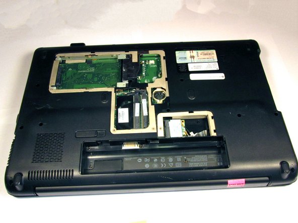

    • Ground yourself by either touching an unpainted metal surface or by using the Anti-Static wrist strap.
    • Turn off the computer and remove the charger from the charging port.
    • Turn the laptop over and slide the battery release catch to the right. The battery will pop up from its slot. Remove it using your fingers.
  2. HP G71t-300 Cooling Fan Replacement: crwdns2935265:02crwdnd2935265:01crwdnd2935265:02crwdne2935265:0 HP G71t-300 Cooling Fan Replacement: crwdns2935265:02crwdnd2935265:02crwdnd2935265:02crwdne2935265:0

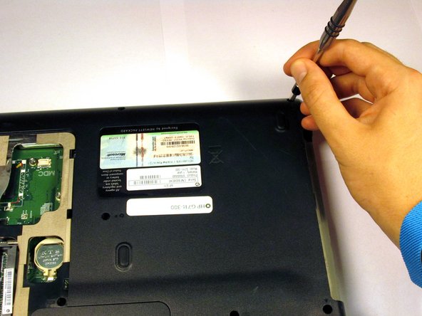

    • Use a Phillips #0 screwdriver to remove the four screws from the indicated cover.
    • Gently lift and remove the cover.

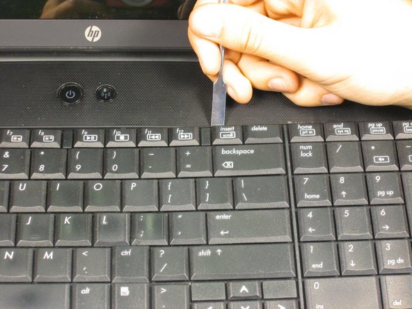

  4. HP G71t-300 Cooling Fan Replacement: crwdns2935265:04crwdnd2935265:01crwdnd2935265:02crwdne2935265:0 HP G71t-300 Cooling Fan Replacement: crwdns2935265:04crwdnd2935265:02crwdnd2935265:02crwdne2935265:0
    • Pry the keyboard off with a spudger. Be careful not to apply too much pressure and damage any components.
  5. HP G71t-300 Cooling Fan Replacement: crwdns2935265:05crwdnd2935265:01crwdnd2935265:02crwdne2935265:0 HP G71t-300 Cooling Fan Replacement: crwdns2935265:05crwdnd2935265:02crwdnd2935265:02crwdne2935265:0
    • Disconnect the clip attaching the keyboard wiring to the motherboard. Lift and remove the keyboard.

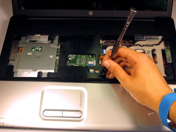

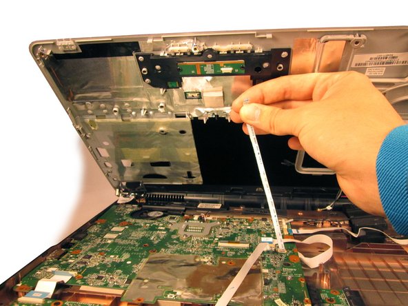

  9. HP G71t-300 Cooling Fan Replacement: crwdns2935265:09crwdnd2935265:01crwdnd2935265:02crwdne2935265:0 HP G71t-300 Cooling Fan Replacement: crwdns2935265:09crwdnd2935265:02crwdnd2935265:02crwdne2935265:0

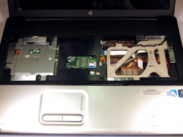

    • Partially separate the two panels until connectors are visible.
    • Unclip the wires that attach the trackpad module to the motherboard.
  10. HP G71t-300 Cooling Fan Replacement: crwdns2935265:010crwdnd2935265:01crwdnd2935265:02crwdne2935265:0 HP G71t-300 Cooling Fan Replacement: crwdns2935265:010crwdnd2935265:02crwdnd2935265:02crwdne2935265:0

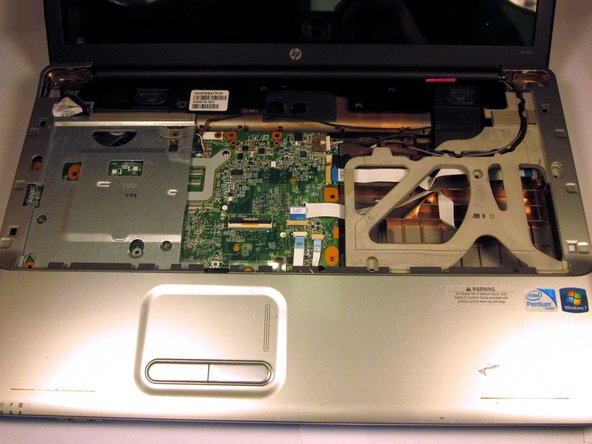

    • Remove the five highlighted screws using a Phillips #0 screwdriver.

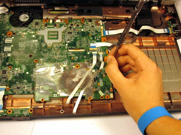

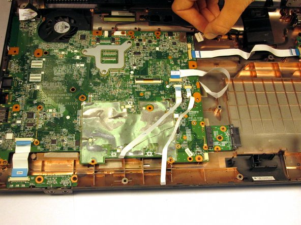

  11. HP G71t-300 Cooling Fan Replacement: crwdns2935265:011crwdnd2935265:01crwdnd2935265:02crwdne2935265:0 HP G71t-300 Cooling Fan Replacement: crwdns2935265:011crwdnd2935265:02crwdnd2935265:02crwdne2935265:0

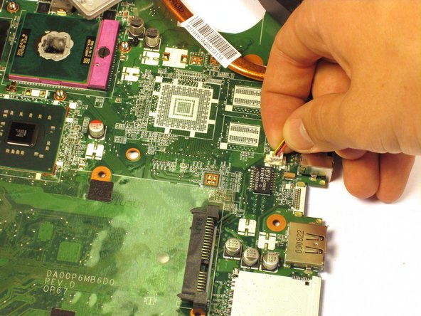

    • Disconnect the five cables by gently pulling them from their slots.
  12. HP G71t-300 Cooling Fan Replacement: crwdns2935265:012crwdnd2935265:01crwdnd2935265:02crwdne2935265:0 HP G71t-300 Cooling Fan Replacement: crwdns2935265:012crwdnd2935265:02crwdnd2935265:02crwdne2935265:0

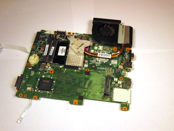

    • Press a metal spudger between the VGA port and the plastic housing to pry up the motherboard.
    • Remove the motherboard and turn it so that the fan is facing upward.
  13. HP G71t-300 Cooling Fan Replacement: crwdns2935265:013crwdnd2935265:01crwdnd2935265:03crwdne2935265:0 HP G71t-300 Cooling Fan Replacement: crwdns2935265:013crwdnd2935265:02crwdnd2935265:03crwdne2935265:0 HP G71t-300 Cooling Fan Replacement: crwdns2935265:013crwdnd2935265:03crwdnd2935265:03crwdne2935265:0

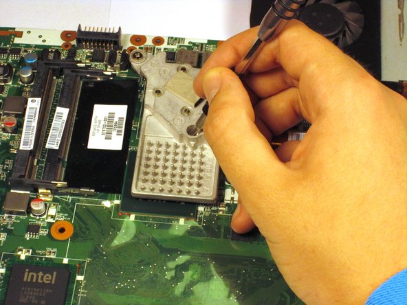

    • Use a Phillips #0 screwdriver to loosen the three screws attaching the heatsink to the motherboard.
    • Remove the heatsink and fan assembly by unclipping the fan from the motherboard.
