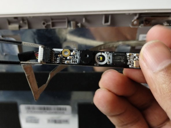

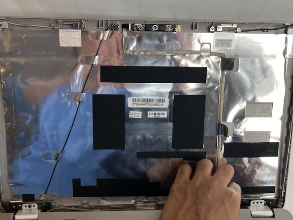

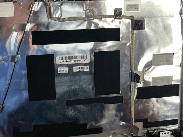

    1. HP G62-234DX Webcam Replacement, Webcam: crwdns2935265:09crwdnd2935265:01crwdnd2935265:03crwdne2935265:0 HP G62-234DX Webcam Replacement, Webcam: crwdns2935265:09crwdnd2935265:02crwdnd2935265:03crwdne2935265:0 HP G62-234DX Webcam Replacement, Webcam: crwdns2935265:09crwdnd2935265:03crwdnd2935265:03crwdne2935265:0
      • Gently unfasten the 6 tabs that hold the webcam cable in place.
    2. HP G62-234DX Webcam Replacement: crwdns2935265:010crwdnd2935265:01crwdnd2935265:01crwdne2935265:0
      • Gently pull the cable off of the display case.
      • It is still connected to the webcam.

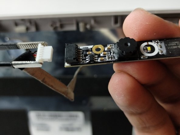

    3. HP G62-234DX Webcam Replacement: crwdns2935265:011crwdnd2935265:01crwdnd2935265:03crwdne2935265:0 HP G62-234DX Webcam Replacement: crwdns2935265:011crwdnd2935265:02crwdnd2935265:03crwdne2935265:0 HP G62-234DX Webcam Replacement: crwdns2935265:011crwdnd2935265:03crwdnd2935265:03crwdne2935265:0
      • Pull the bundled cable connector from the webcam in the same direction as the individual wires are running.
      • Pull evenly on the full width of the cable so that no individual wires are overly strained.
      • Use a spudger to remove the webcam from the case.
