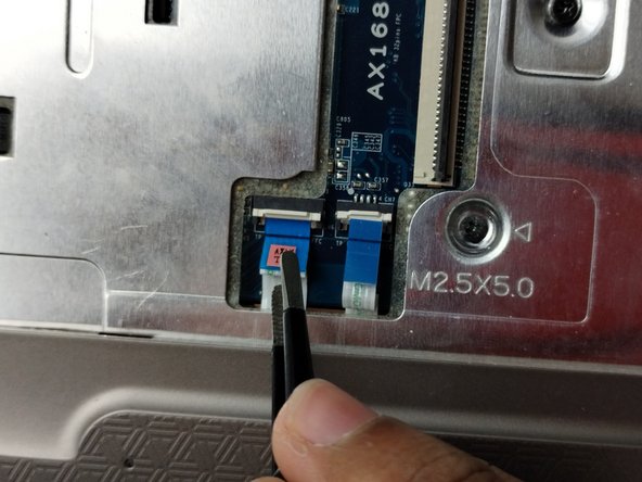

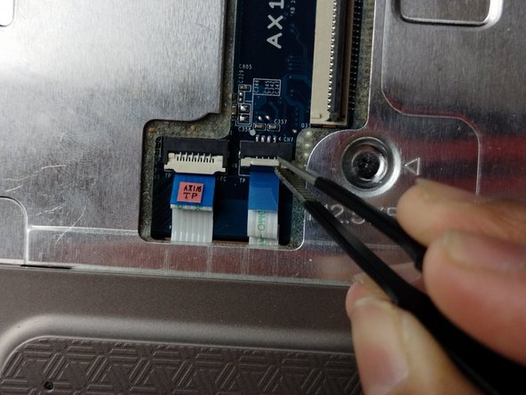

    1. HP G62-234DX Trackpad Replacement, Trackpad: crwdns2935265:012crwdnd2935265:01crwdnd2935265:03crwdne2935265:0 HP G62-234DX Trackpad Replacement, Trackpad: crwdns2935265:012crwdnd2935265:02crwdnd2935265:03crwdne2935265:0 HP G62-234DX Trackpad Replacement, Trackpad: crwdns2935265:012crwdnd2935265:03crwdnd2935265:03crwdne2935265:0
      • Use a Phillips #0 screwdriver to remove two 6.0 mm screws.
      • Use the tip of a spudger or your fingernail to flip up the small locking flaps on the three connectors attached to the trackpad.
      • Pull the cables out gently.

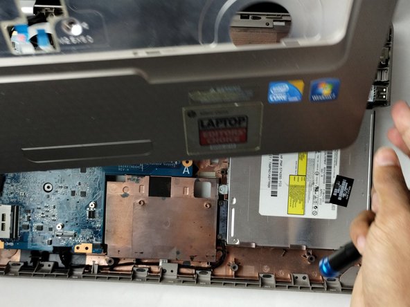

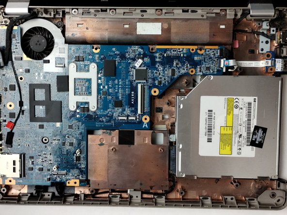

    2. HP G62-234DX Trackpad Replacement: crwdns2935265:013crwdnd2935265:01crwdnd2935265:03crwdne2935265:0 HP G62-234DX Trackpad Replacement: crwdns2935265:013crwdnd2935265:02crwdnd2935265:03crwdne2935265:0 HP G62-234DX Trackpad Replacement: crwdns2935265:013crwdnd2935265:03crwdnd2935265:03crwdne2935265:0
      • Use an opening tool and picks to pry the palm rest assembly from the device.
      • The trackpad is built into the palm rest assembly.
