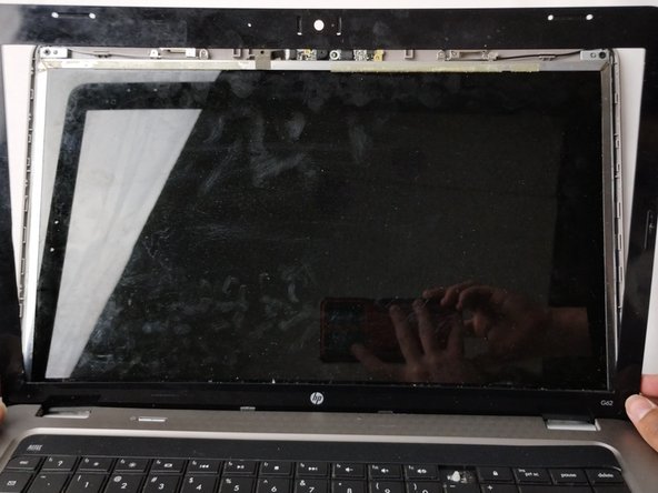

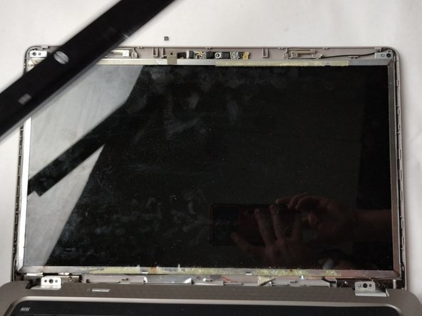

    • Flip over the laptop and open the laptop.
    • Using a spudger and opening picks, loosen the screen bezel (outer frame).
    • Start from one side of the bezel and work your way around to the other side.
  3. HP G62-234DX Screen Replacement: crwdns2935265:03crwdnd2935265:01crwdnd2935265:03crwdne2935265:0 HP G62-234DX Screen Replacement: crwdns2935265:03crwdnd2935265:02crwdnd2935265:03crwdne2935265:0 HP G62-234DX Screen Replacement: crwdns2935265:03crwdnd2935265:03crwdnd2935265:03crwdne2935265:0
    • Lift the screen bezel with your fingers to reveal the screen unit.

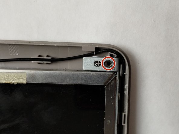

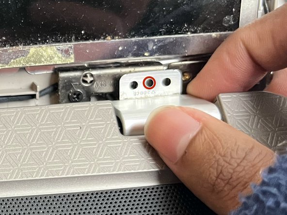

    • Use a Phillips #0 screwdriver to remove one 4.0 mm screw on the left and right hinges.
    • Lift the hinges with your fingers.

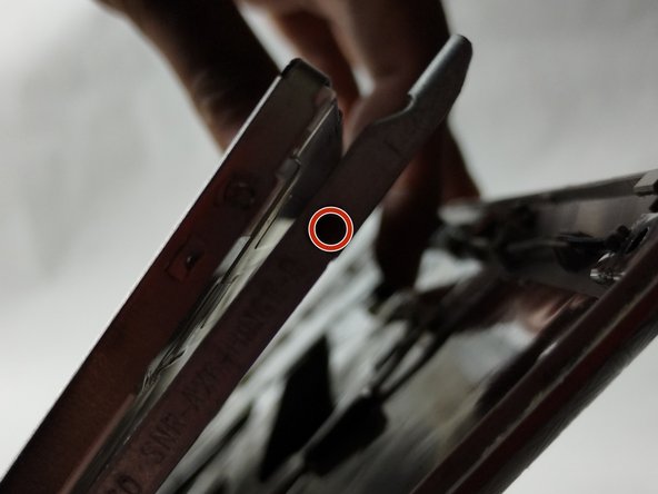

    • Use a Phillips #0 screwdriver to remove the two 3.0 mm screws on the top of the display.
  6. HP G62-234DX Screen Replacement: crwdns2935265:06crwdnd2935265:01crwdnd2935265:02crwdne2935265:0 HP G62-234DX Screen Replacement: crwdns2935265:06crwdnd2935265:02crwdnd2935265:02crwdne2935265:0
    • Use a Phillips #0 screwdriver to remove a total of four 3.0 mm screws along the edge of both sides of the screen.

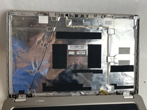

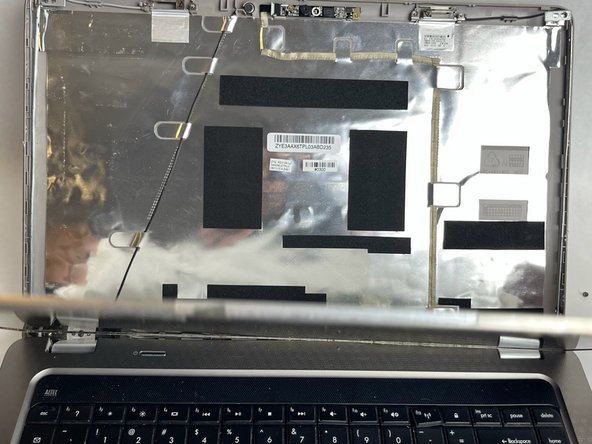

    • Carefully loosen the adhesive under the screen unit using your spudger.
    • Pull off the screen unit using your fingers.
    • The screen is still connected by the display cable.

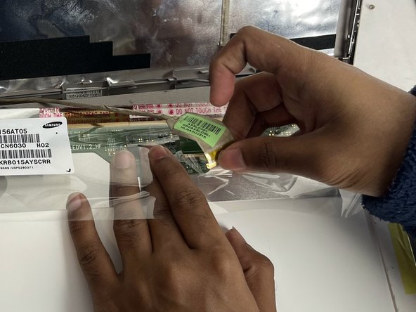

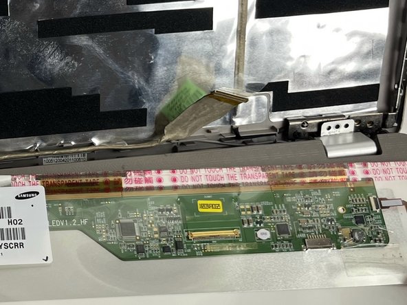

  8. HP G62-234DX Screen Replacement: crwdns2935265:08crwdnd2935265:01crwdnd2935265:03crwdne2935265:0 HP G62-234DX Screen Replacement: crwdns2935265:08crwdnd2935265:02crwdnd2935265:03crwdne2935265:0 HP G62-234DX Screen Replacement: crwdns2935265:08crwdnd2935265:03crwdnd2935265:03crwdne2935265:0
    • To disconnect the display cable connector, gently push the tip of a spudger under the clip. Then, swing the clip over to the other side of the socket, so that it lays flat against the cable.
    • Lift the protective film slightly and, holding the clip and cable together, gently pull in the direction of the cable to remove the connector from its socket.
    • Safely remove the screen.
