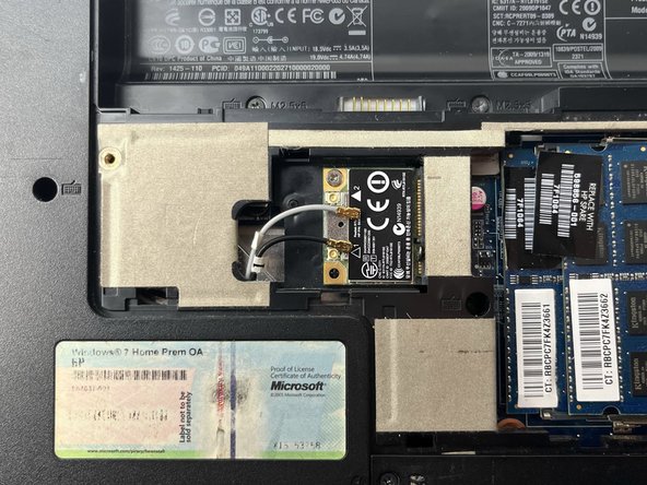

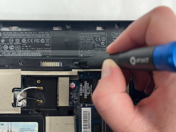

    2. HP G62-234DX Fan Replacement: crwdns2935265:02crwdnd2935265:01crwdnd2935265:03crwdne2935265:0 HP G62-234DX Fan Replacement: crwdns2935265:02crwdnd2935265:02crwdnd2935265:03crwdne2935265:0 HP G62-234DX Fan Replacement: crwdns2935265:02crwdnd2935265:03crwdnd2935265:03crwdne2935265:0
      • Use a Phillips #0 screwdriver to remove the three 6.0 mm screws.
      • The screws that are attached to the panel do not need to be removed completely.
      • Remove the back panel to access the Wi-Fi card.

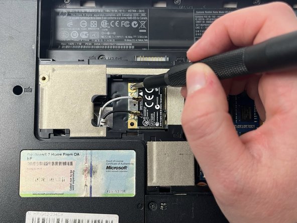

    3. HP G62-234DX Fan Replacement: crwdns2935265:03crwdnd2935265:01crwdnd2935265:03crwdne2935265:0 HP G62-234DX Fan Replacement: crwdns2935265:03crwdnd2935265:02crwdnd2935265:03crwdne2935265:0 HP G62-234DX Fan Replacement: crwdns2935265:03crwdnd2935265:03crwdnd2935265:03crwdne2935265:0
      • Slide a thin, ESD-safe pry tool or tweezers under the wire until it's snug against the connector, and pry straight up from the board to disconnect the coaxial cables from the Wi-Fi card.

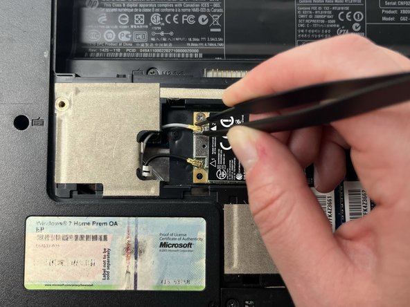

    4. HP G62-234DX Fan Replacement: crwdns2935265:04crwdnd2935265:01crwdnd2935265:02crwdne2935265:0 HP G62-234DX Fan Replacement: crwdns2935265:04crwdnd2935265:02crwdnd2935265:02crwdne2935265:0

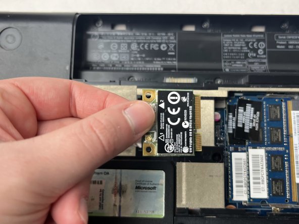

      • Use a Phillips #0 screwdriver to remove the 3.0 mm screw from the Wi-Fi card.
      • When the screw is removed the card will pop up at a 45-degree angle.

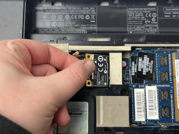

    5. HP G62-234DX Fan Replacement: crwdns2935265:05crwdnd2935265:01crwdnd2935265:03crwdne2935265:0 HP G62-234DX Fan Replacement: crwdns2935265:05crwdnd2935265:02crwdnd2935265:03crwdne2935265:0 HP G62-234DX Fan Replacement: crwdns2935265:05crwdnd2935265:03crwdnd2935265:03crwdne2935265:0
      • Remove the Wi-Fi card by sliding it out from the socket.

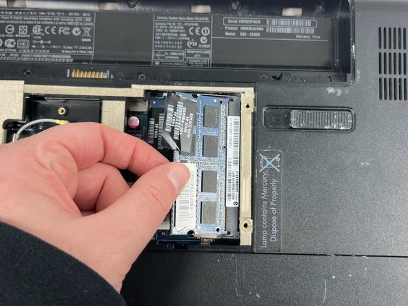

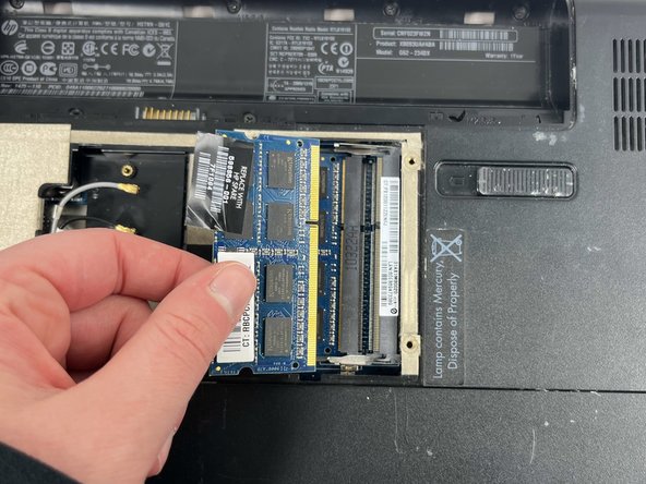

    1. HP G62-234DX Fan Replacement, Keyboard: crwdns2935265:06crwdnd2935265:01crwdnd2935265:03crwdne2935265:0 HP G62-234DX Fan Replacement, Keyboard: crwdns2935265:06crwdnd2935265:02crwdnd2935265:03crwdne2935265:0 HP G62-234DX Fan Replacement, Keyboard: crwdns2935265:06crwdnd2935265:03crwdnd2935265:03crwdne2935265:0
      • Release the tabs on each side of the chip by simultaneously pushing each tab away from the RAM chip.
      • These tabs lock the chip in place and releasing them will cause the chip to "pop" up.
      • Slide the RAM card out of the slot to remove it.

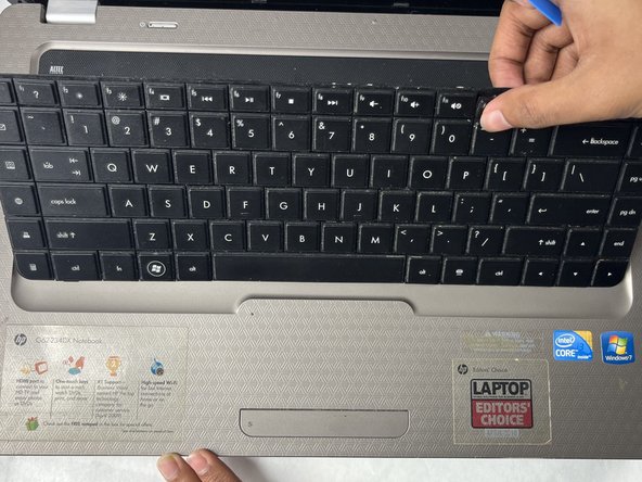

    3. HP G62-234DX Fan Replacement: crwdns2935265:08crwdnd2935265:01crwdnd2935265:02crwdne2935265:0 HP G62-234DX Fan Replacement: crwdns2935265:08crwdnd2935265:02crwdnd2935265:02crwdne2935265:0

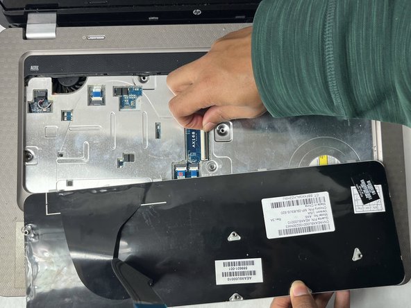

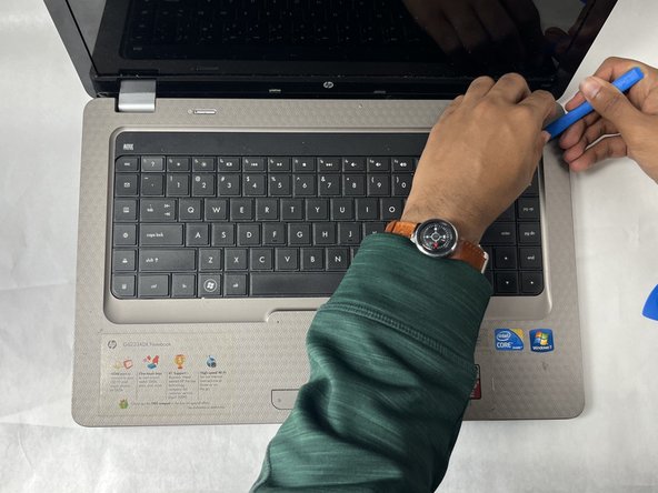

      • Rotate the laptop back to its standard orientation and flip open the screen.
      • Use the iFixit opening tool to separate the keyboard from the tabs. Start from one point on the edge and work your way around until all of the tabs are released.

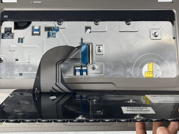

    4. HP G62-234DX Fan Replacement: crwdns2935265:09crwdnd2935265:01crwdnd2935265:03crwdne2935265:0 HP G62-234DX Fan Replacement: crwdns2935265:09crwdnd2935265:02crwdnd2935265:03crwdne2935265:0 HP G62-234DX Fan Replacement: crwdns2935265:09crwdnd2935265:03crwdnd2935265:03crwdne2935265:0
      • Flip the keyboard towards yourself.
      • Do not try to pull it out, as it is still connected to the ribbon cable.
    5. HP G62-234DX Fan Replacement: crwdns2935265:010crwdnd2935265:01crwdnd2935265:02crwdne2935265:0 HP G62-234DX Fan Replacement: crwdns2935265:010crwdnd2935265:02crwdnd2935265:02crwdne2935265:0
      • Flip up the locking flap using either your fingernail, or a spudger.
      • Remove the ribbon from the ZIF connector.
    6. HP G62-234DX Fan Replacement: crwdns2935265:011crwdnd2935265:01crwdnd2935265:01crwdne2935265:0
      • Remove the keyboard.

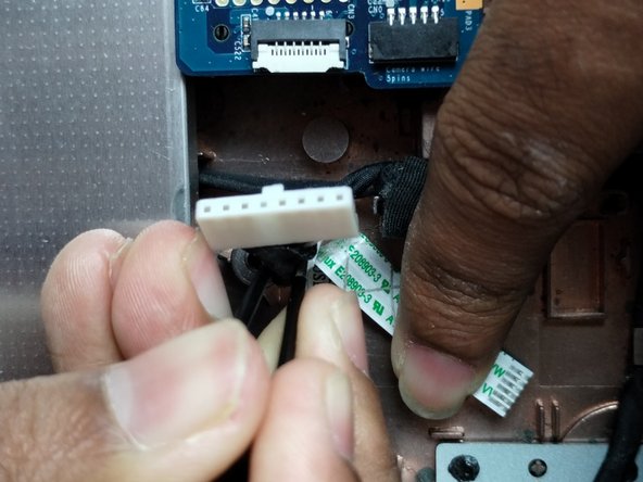

    2. HP G62-234DX Fan Replacement: crwdns2935265:013crwdnd2935265:01crwdnd2935265:03crwdne2935265:0 HP G62-234DX Fan Replacement: crwdns2935265:013crwdnd2935265:02crwdnd2935265:03crwdne2935265:0 HP G62-234DX Fan Replacement: crwdns2935265:013crwdnd2935265:03crwdnd2935265:03crwdne2935265:0
      • Use a Phillips #0 screwdriver to remove two 6.0 mm screws.

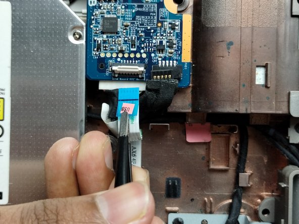

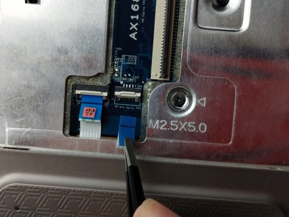

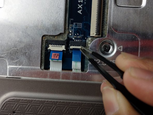

      • Use the tip of a spudger or your fingernail to flip up the small locking flap on the three ZIF connectors.
      • Pull the cables out from the connectors attached to the touchpad and fan.

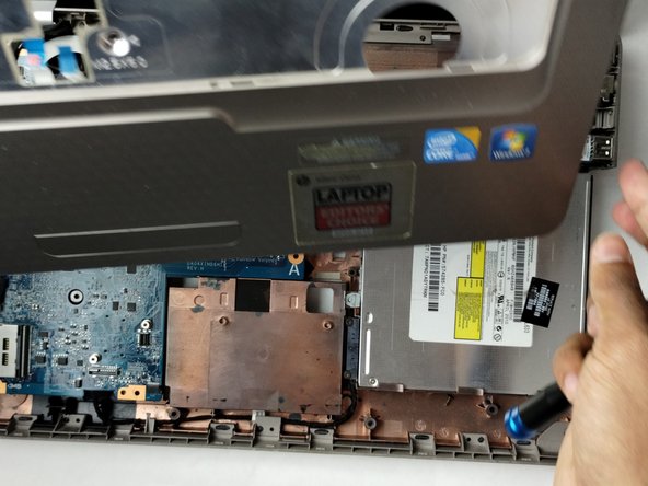

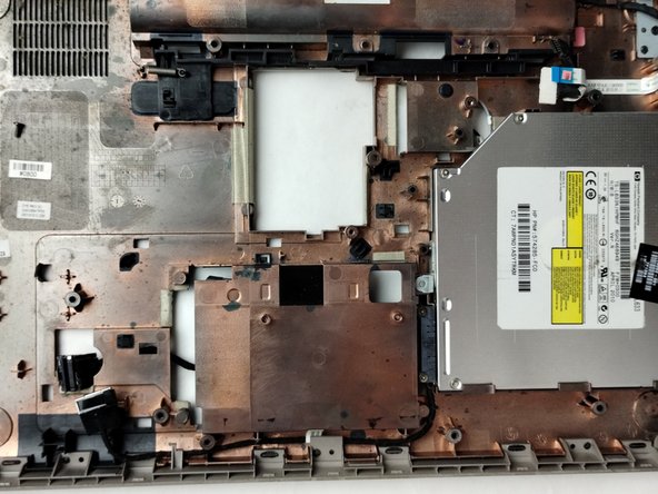

    3. HP G62-234DX Fan Replacement: crwdns2935265:014crwdnd2935265:01crwdnd2935265:03crwdne2935265:0 HP G62-234DX Fan Replacement: crwdns2935265:014crwdnd2935265:02crwdnd2935265:03crwdne2935265:0 HP G62-234DX Fan Replacement: crwdns2935265:014crwdnd2935265:03crwdnd2935265:03crwdne2935265:0

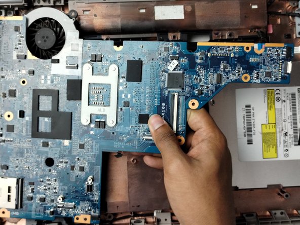

      • Use a spudger and opening picks to pry the palm rest assembly from the laptop.

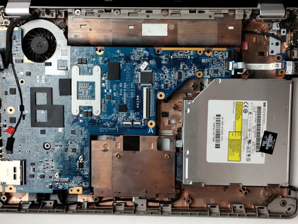

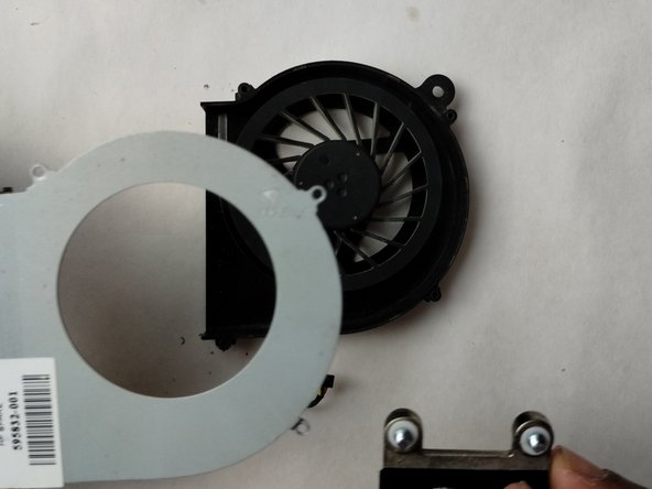

    4. HP G62-234DX Fan Replacement: crwdns2935265:015crwdnd2935265:01crwdnd2935265:03crwdne2935265:0 HP G62-234DX Fan Replacement: crwdns2935265:015crwdnd2935265:02crwdnd2935265:03crwdne2935265:0 HP G62-234DX Fan Replacement: crwdns2935265:015crwdnd2935265:03crwdnd2935265:03crwdne2935265:0
    5. HP G62-234DX Fan Replacement: crwdns2935265:016crwdnd2935265:01crwdnd2935265:03crwdne2935265:0 HP G62-234DX Fan Replacement: crwdns2935265:016crwdnd2935265:02crwdnd2935265:03crwdne2935265:0 HP G62-234DX Fan Replacement: crwdns2935265:016crwdnd2935265:03crwdnd2935265:03crwdne2935265:0
      • Use a Phillips #0 screwdriver to loosen the captive screw securing the fan.
      • Lift the motherboard slowly from the right side and take off gently.
      • Do not pull too hard if you encounter a lot of resistance; double-check if you forgot to remove any screws.

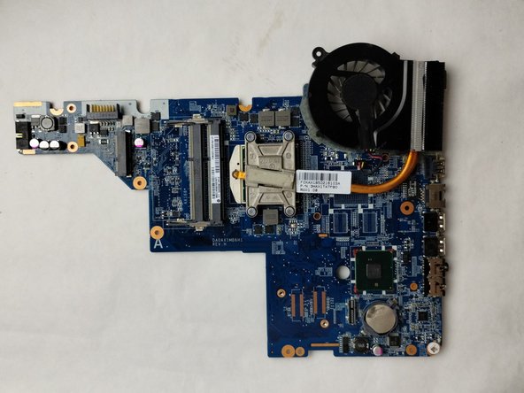

    6. HP G62-234DX Fan Replacement: crwdns2935265:017crwdnd2935265:01crwdnd2935265:02crwdne2935265:0 HP G62-234DX Fan Replacement: crwdns2935265:017crwdnd2935265:02crwdnd2935265:02crwdne2935265:0
      • Flip the motherboard over.

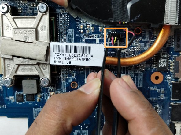

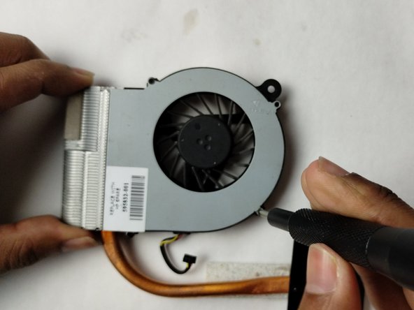

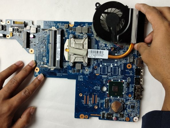

    7. HP G62-234DX Fan Replacement: crwdns2935265:018crwdnd2935265:01crwdnd2935265:03crwdne2935265:0 HP G62-234DX Fan Replacement: crwdns2935265:018crwdnd2935265:02crwdnd2935265:03crwdne2935265:0 HP G62-234DX Fan Replacement: crwdns2935265:018crwdnd2935265:03crwdnd2935265:03crwdne2935265:0
      • Use a Phillips #0 screwdriver to loosen the screws on the CPU block.
      • Disconnect the power cable right next to the fan.
      • Gently remove the fan assembly.

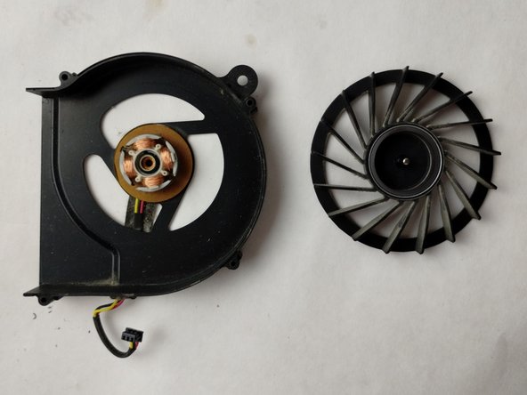

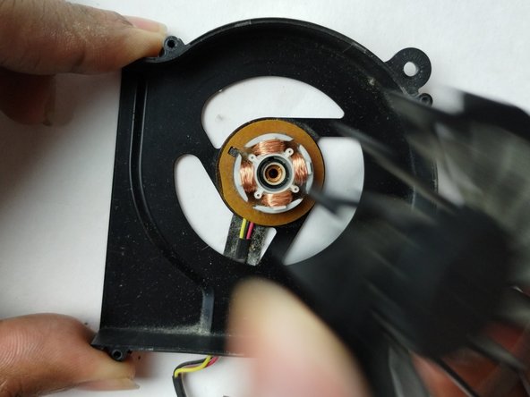

    8. HP G62-234DX Fan Replacement: crwdns2935265:019crwdnd2935265:01crwdnd2935265:03crwdne2935265:0 HP G62-234DX Fan Replacement: crwdns2935265:019crwdnd2935265:02crwdnd2935265:03crwdne2935265:0 HP G62-234DX Fan Replacement: crwdns2935265:019crwdnd2935265:03crwdnd2935265:03crwdne2935265:0
      • Use a Phillips #0 screwdriver to remove the screws from the fan.
    9. HP G62-234DX Fan Replacement: crwdns2935265:020crwdnd2935265:01crwdnd2935265:03crwdne2935265:0 HP G62-234DX Fan Replacement: crwdns2935265:020crwdnd2935265:02crwdnd2935265:03crwdne2935265:0 HP G62-234DX Fan Replacement: crwdns2935265:020crwdnd2935265:03crwdnd2935265:03crwdne2935265:0
      • Gently take off the blades.
