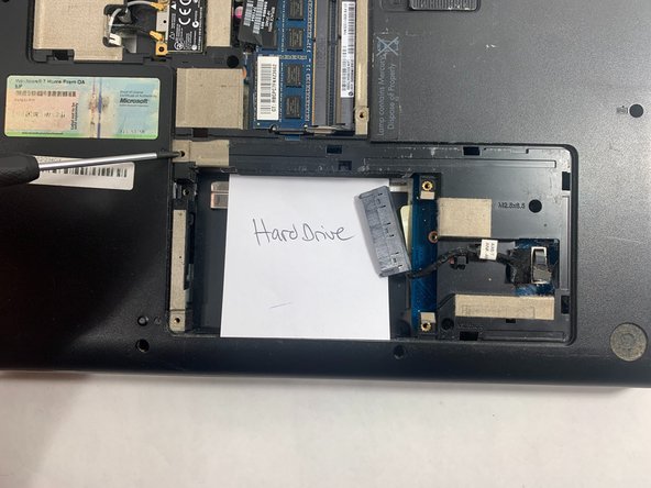

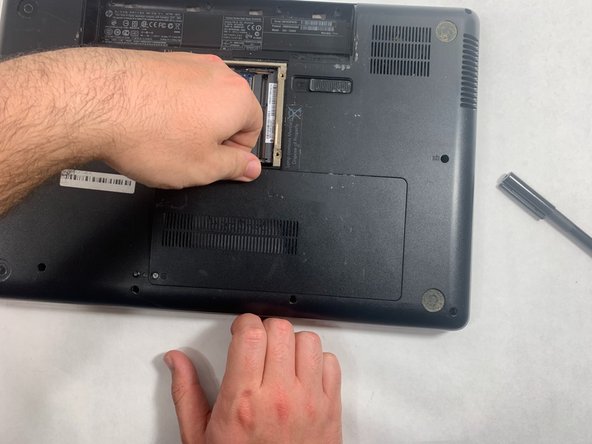

  3. HP G62-234DX CD Reader Replacement, Hard Drive: crwdns2935265:03crwdnd2935265:01crwdnd2935265:03crwdne2935265:0 HP G62-234DX CD Reader Replacement, Hard Drive: crwdns2935265:03crwdnd2935265:02crwdnd2935265:03crwdne2935265:0 HP G62-234DX CD Reader Replacement, Hard Drive: crwdns2935265:03crwdnd2935265:03crwdnd2935265:03crwdne2935265:0
    • It Is recommended to remove the RAM panel for easier access when removing the hard drive panel.
    • Use a Phillips #0 screwdriver to remove the two screws securing the hard drive panel on the back of the laptop.
    • Use a spudger to remove hard drive panel and carefully lift it up and out.
  4. HP G62-234DX CD Reader Replacement: crwdns2935265:04crwdnd2935265:01crwdnd2935265:01crwdne2935265:0
    • Pull the hard drive from the SATA connector to remove the hard drive from the laptop.

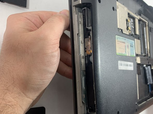

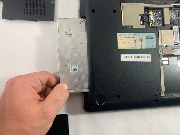

  5. HP G62-234DX CD Reader Replacement, CD Reader: crwdns2935265:05crwdnd2935265:01crwdnd2935265:02crwdne2935265:0 HP G62-234DX CD Reader Replacement, CD Reader: crwdns2935265:05crwdnd2935265:02crwdnd2935265:02crwdne2935265:0
    • Use a Phillips #0 screwdriver to remove the screw that holds the CD reader or optical driver in place.
    • Since there is no cover for this device this will be a improvised removal of the CD reader.
  6. HP G62-234DX CD Reader Replacement: crwdns2935265:06crwdnd2935265:01crwdnd2935265:02crwdne2935265:0 HP G62-234DX CD Reader Replacement: crwdns2935265:06crwdnd2935265:02crwdnd2935265:02crwdne2935265:0
    • To remove the CD reader gently push the the back of the CD reader from the hard drive slot and pull it out on the other side.
