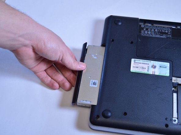

    1. HP G62-223CL Optical Drive Replacement, Optical Drive: crwdns2935265:03crwdnd2935265:01crwdnd2935265:01crwdne2935265:0
      • Locate two Phillips head retaining screws which secure the hard drive compartment.
      • Use a Phillips #0 screwdriver to loosen the retaining screws.
      • Remove the panel covering the compartment.
      • Ground yourself before attempting to touch any components. To ground yourself, touch a conductive metal to eliminate any static buildup in your body, which can damage computer components.
    2. HP G62-223CL Optical Drive Replacement: crwdns2935265:04crwdnd2935265:01crwdnd2935265:01crwdne2935265:0
      • Locate the 6 mm Phillips head screw to the left of the hard drive.
      • Use a Phillips #0 screwdriver to remove the screw.
    3. HP G62-223CL Optical Drive Replacement: crwdns2935265:05crwdnd2935265:01crwdnd2935265:02crwdne2935265:0 HP G62-223CL Optical Drive Replacement: crwdns2935265:05crwdnd2935265:02crwdnd2935265:02crwdne2935265:0
      • Once the screw is removed, use a plastic opening tool and place it between the body of the computer and the optical drive.
      • Apply enough pressure to loosen the optical drive.
      • The optical drive can then be removed by hand.
