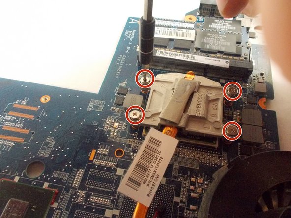

  19. HP G62-144DX Fan/heat Sink module Replacement, Fan/heat Sink module: crwdns2935265:019crwdnd2935265:01crwdnd2935265:02crwdne2935265:0 HP G62-144DX Fan/heat Sink module Replacement, Fan/heat Sink module: crwdns2935265:019crwdnd2935265:02crwdnd2935265:02crwdne2935265:0
    • Shut down the computer. If you are unsure whether the computer is off or in Hibernation, turn on the computer, and then shut it down through the operating system.
    • Disconnect all external devices connected to the computer.
    • Disconnect the power from the computer by first disconnecting the power cord from the AC outlet and then disconnecting the AC adapter from the computer.
    • Disconnect the fan cable from the system board.
    • Loosen the four Phillips PM2.5×7.0 captive screws that secure the fan/heat sink assembly to the system board with a Phillips 0 screwdriver.
