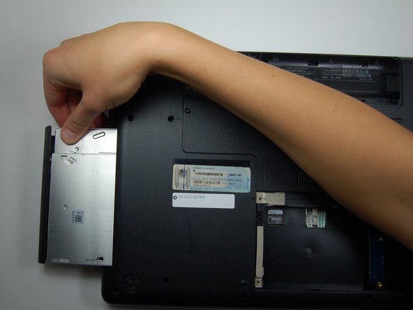

  4. HP G62 347NR  CD/DVD Drive Replacement: crwdns2935265:04crwdnd2935265:01crwdnd2935265:01crwdne2935265:0
    • On the far left of the hard drive compartment, find the Phillips head screw.
    • Remove the Phillips head screw with the PH1 screwdriver.
  5. HP G62 347NR  CD/DVD Drive Replacement: crwdns2935265:05crwdnd2935265:01crwdnd2935265:02crwdne2935265:0 HP G62 347NR  CD/DVD Drive Replacement: crwdns2935265:05crwdnd2935265:02crwdnd2935265:02crwdne2935265:0
    • Get the plastic opening tool and place it between the laptop and the CD/DVD drive. Place it toward the center of the drive for maximum support.
    • Carefully pry the CD/DVD drive open.
    • Slide the CD/DVD drive out once it is pried open.
