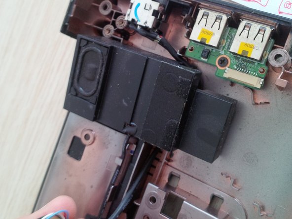

  11. HP G61-430SB Teardown: crwdns2935265:011crwdnd2935265:01crwdnd2935265:02crwdne2935265:0 HP G61-430SB Teardown: crwdns2935265:011crwdnd2935265:02crwdnd2935265:02crwdne2935265:0
    • Remove the black plastic.
    • Remove the audio boxes.
    • Remove all the other wires and cables.
    • Then gently separate the screen from the case.
