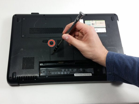

    1. HP G60T-600 CTO RAM Replacement, RAM: crwdns2935265:04crwdnd2935265:01crwdnd2935265:01crwdne2935265:0
      • Turn your device over and orient it so the battery is facing you.
    2. HP G60T-600 CTO RAM Replacement: crwdns2935265:05crwdnd2935265:01crwdnd2935265:03crwdne2935265:0 HP G60T-600 CTO RAM Replacement: crwdns2935265:05crwdnd2935265:02crwdnd2935265:03crwdne2935265:0 HP G60T-600 CTO RAM Replacement: crwdns2935265:05crwdnd2935265:03crwdnd2935265:03crwdne2935265:0
      • Unscrew the following 5mm screws using a Phillips head #0 screwdriver.
      • Remove the cover.

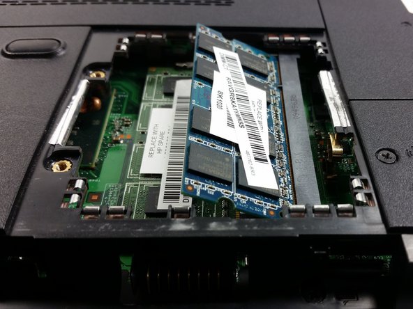

    3. HP G60T-600 CTO RAM Replacement: crwdns2935265:06crwdnd2935265:01crwdnd2935265:03crwdne2935265:0 HP G60T-600 CTO RAM Replacement: crwdns2935265:06crwdnd2935265:02crwdnd2935265:03crwdne2935265:0 HP G60T-600 CTO RAM Replacement: crwdns2935265:06crwdnd2935265:03crwdnd2935265:03crwdne2935265:0

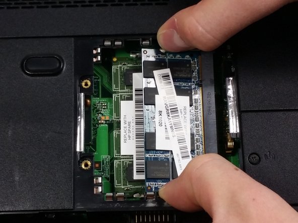

      • Place your fingers on little metals tabs on both sides of the RAM casing.
      • Push the tabs towards the sides. This should cause the RAM to pop up.
    4. HP G60T-600 CTO RAM Replacement: crwdns2935265:07crwdnd2935265:01crwdnd2935265:01crwdne2935265:0
      • Pull on it with medium force at the angle it is oriented.
