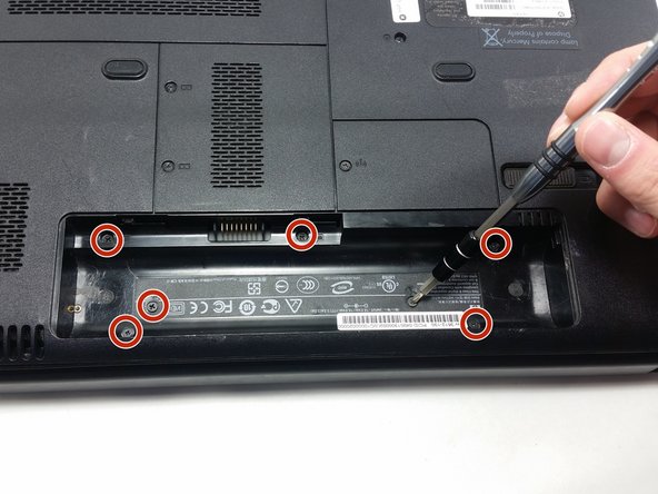

    1. HP G60T-600 CTO Power Button Frame Replacement, Keyboard: crwdns2935265:04crwdnd2935265:01crwdnd2935265:02crwdne2935265:0 HP G60T-600 CTO Power Button Frame Replacement, Keyboard: crwdns2935265:04crwdnd2935265:02crwdnd2935265:02crwdne2935265:0
      • Unscrew the following 5mm screws with a #0 Phillips screwdriver.

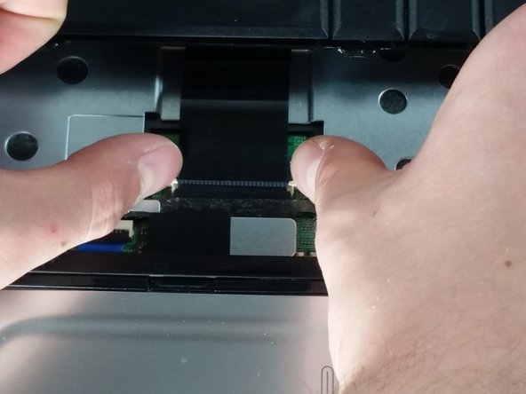

    4. HP G60T-600 CTO Power Button Frame Replacement: crwdns2935265:07crwdnd2935265:01crwdnd2935265:02crwdne2935265:0 HP G60T-600 CTO Power Button Frame Replacement: crwdns2935265:07crwdnd2935265:02crwdnd2935265:02crwdne2935265:0
      • Place your thumbs on the two small, white tabs.
      • Push these tabs forward to release the connection and free the keyboard from the device.

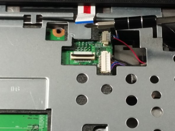

    1. HP G60T-600 CTO Power Button Frame Replacement, Power Button Frame: crwdns2935265:08crwdnd2935265:01crwdnd2935265:01crwdne2935265:0
      • Similarly to how you remove the keyboard, gently pry a small section of the power button frame up.
    2. HP G60T-600 CTO Power Button Frame Replacement: crwdns2935265:09crwdnd2935265:01crwdnd2935265:02crwdne2935265:0 HP G60T-600 CTO Power Button Frame Replacement: crwdns2935265:09crwdnd2935265:02crwdnd2935265:02crwdne2935265:0
      • Gently pull the white tab upwards.
      • With similar force, pull the connection out.
      • You are now free to pull the power button frame off of your device.
    3. HP G60T-600 CTO Power Button Frame Replacement: crwdns2935265:010crwdnd2935265:01crwdnd2935265:01crwdne2935265:0
      • Unscrew the 5mm screw holding the CD player in place.
