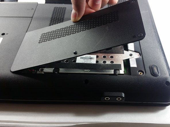

  4. HP G60T-600 CTO Hard drive Replacement, Hard drive: crwdns2935265:04crwdnd2935265:01crwdnd2935265:02crwdne2935265:0 HP G60T-600 CTO Hard drive Replacement, Hard drive: crwdns2935265:04crwdnd2935265:02crwdnd2935265:02crwdne2935265:0
    • Remove the 5cm screws with a #00 Phillips screwdriver.
    • Take the cover off.

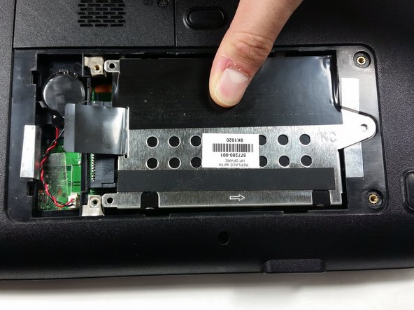

  5. HP G60T-600 CTO Hard drive Replacement: crwdns2935265:05crwdnd2935265:01crwdnd2935265:03crwdne2935265:0 HP G60T-600 CTO Hard drive Replacement: crwdns2935265:05crwdnd2935265:02crwdnd2935265:03crwdne2935265:0 HP G60T-600 CTO Hard drive Replacement: crwdns2935265:05crwdnd2935265:03crwdnd2935265:03crwdne2935265:0
    • Remove the following .5cm screws with a #0 Phillips screwdriver.
    • Slide the hard drive cover to the right with light-medium force.

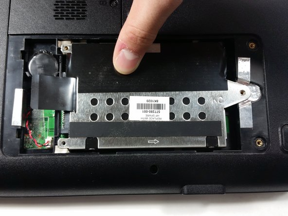

  6. HP G60T-600 CTO Hard drive Replacement: crwdns2935265:06crwdnd2935265:01crwdnd2935265:01crwdne2935265:0
    • Pull up on the little black tab on the hard drive case to remove it.
    • From here you will be able to carefully slide your hard drive out.
