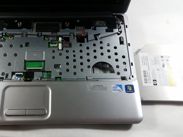

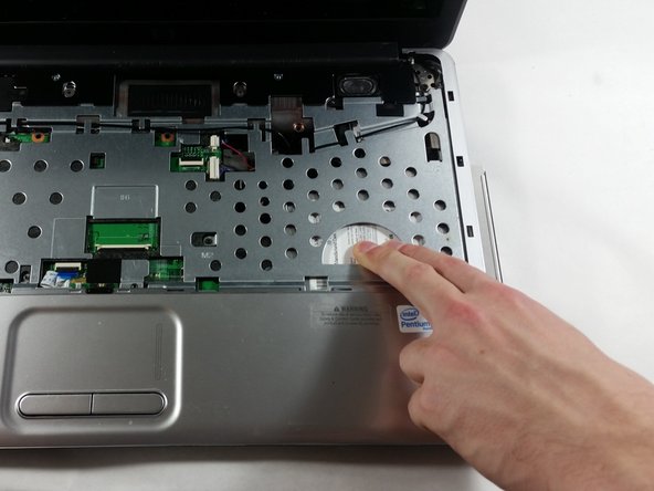

  10. HP G60T-600 CTO CD Player Replacement: crwdns2935265:010crwdnd2935265:01crwdnd2935265:01crwdne2935265:0
    • Unscrew the 5mm screw holding the CD player in place.
  11. HP G60T-600 CTO CD Player Replacement, CD Player: crwdns2935265:011crwdnd2935265:01crwdnd2935265:03crwdne2935265:0 HP G60T-600 CTO CD Player Replacement, CD Player: crwdns2935265:011crwdnd2935265:02crwdnd2935265:03crwdne2935265:0 HP G60T-600 CTO CD Player Replacement, CD Player: crwdns2935265:011crwdnd2935265:03crwdnd2935265:03crwdne2935265:0
    • Slide the CD player case away from the device with medium-hard force, it should come right out.
