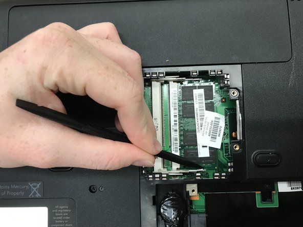

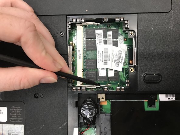

    • Unscrew and remove the two 5mm Philips #0 screws that keep the cover on.
  2. HP G60-443CL RAM Replacement: crwdns2935265:02crwdnd2935265:01crwdnd2935265:02crwdne2935265:0 HP G60-443CL RAM Replacement: crwdns2935265:02crwdnd2935265:02crwdnd2935265:02crwdne2935265:0
    • Remove cover.
  3. HP G60-443CL RAM Replacement: crwdns2935265:03crwdnd2935265:01crwdnd2935265:02crwdne2935265:0 HP G60-443CL RAM Replacement: crwdns2935265:03crwdnd2935265:02crwdnd2935265:02crwdne2935265:0
    • Press on the two levers on either side of the first RAM.
    • The RAM will pop up if the levers have been pushed properly.
  4. HP G60-443CL RAM Replacement: crwdns2935265:04crwdnd2935265:01crwdnd2935265:01crwdne2935265:0
    • Gently remove the first RAM.
  5. HP G60-443CL RAM Replacement: crwdns2935265:05crwdnd2935265:01crwdnd2935265:02crwdne2935265:0 HP G60-443CL RAM Replacement: crwdns2935265:05crwdnd2935265:02crwdnd2935265:02crwdne2935265:0
    • Repeat steps 1-4 for the second RAM.
    • After gently taking the second RAM out, the RAMs have successfully been removed.
