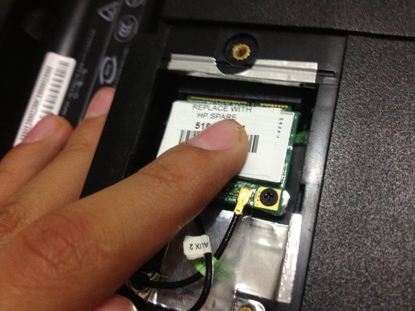

    • First, remove the battery to avoid electric shock
    • Slide and unlock the battery, then lift it

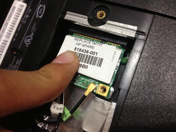

  2. HP G60 Wi-Fi Card Replacement, Wi-Fi card: crwdns2935265:02crwdnd2935265:01crwdnd2935265:03crwdne2935265:0 HP G60 Wi-Fi Card Replacement, Wi-Fi card: crwdns2935265:02crwdnd2935265:02crwdnd2935265:03crwdne2935265:0 HP G60 Wi-Fi Card Replacement, Wi-Fi card: crwdns2935265:02crwdnd2935265:03crwdnd2935265:03crwdne2935265:0
    • Now, you should to remove the Wi-Fi card cover
    • Remove this screw
    • Lift the cover

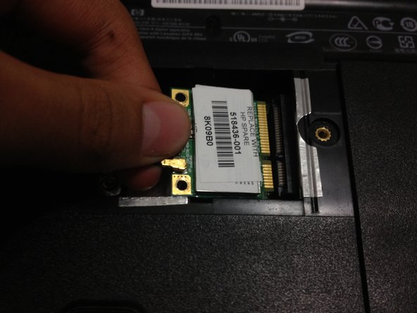

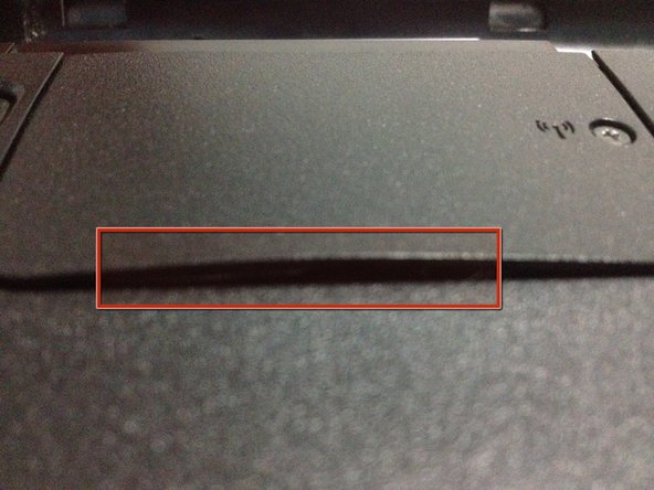

  3. HP G60 Wi-Fi Card Replacement, Unlock Wi-Fi card: crwdns2935265:03crwdnd2935265:01crwdnd2935265:03crwdne2935265:0 HP G60 Wi-Fi Card Replacement, Unlock Wi-Fi card: crwdns2935265:03crwdnd2935265:02crwdnd2935265:03crwdne2935265:0 HP G60 Wi-Fi Card Replacement, Unlock Wi-Fi card: crwdns2935265:03crwdnd2935265:03crwdnd2935265:03crwdne2935265:0
    • The Wi-Fi card is locked, but you should to change that.
    • Remove this two little screws.
    • Pull the Wi-Fi card.

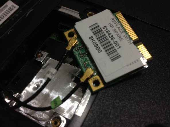

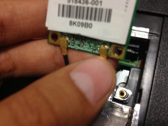

  4. HP G60 Wi-Fi Card Replacement, Unplug Wi-Fi card: crwdns2935265:04crwdnd2935265:01crwdnd2935265:03crwdne2935265:0 HP G60 Wi-Fi Card Replacement, Unplug Wi-Fi card: crwdns2935265:04crwdnd2935265:02crwdnd2935265:03crwdne2935265:0 HP G60 Wi-Fi Card Replacement, Unplug Wi-Fi card: crwdns2935265:04crwdnd2935265:03crwdnd2935265:03crwdne2935265:0
    • You should to be carefull with the next steps, the plugs are easy to separate, but they are fragile
    • Pull carefully both cables from the Wi-Fi card, it requires a little strength

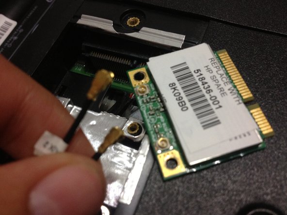

  5. HP G60 Wi-Fi Card Replacement, Reassemble Wi-Fi card: crwdns2935265:05crwdnd2935265:01crwdnd2935265:02crwdne2935265:0 HP G60 Wi-Fi Card Replacement, Reassemble Wi-Fi card: crwdns2935265:05crwdnd2935265:02crwdnd2935265:02crwdne2935265:0
    • Now it's time to put the new Wi-Fi card
    • Connect both plugs, the cable with white tag, at the left of the Wi-Fi card, the green one, at the right plug

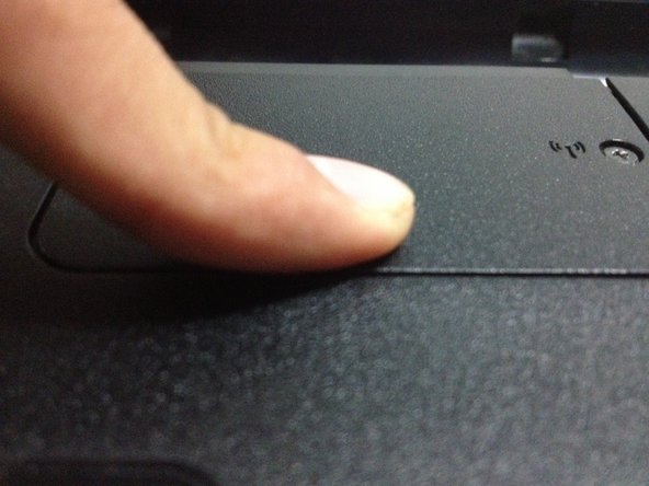

  7. HP G60 Wi-Fi Card Replacement, Reassemble cover: crwdns2935265:07crwdnd2935265:01crwdnd2935265:03crwdne2935265:0 HP G60 Wi-Fi Card Replacement, Reassemble cover: crwdns2935265:07crwdnd2935265:02crwdnd2935265:03crwdne2935265:0 HP G60 Wi-Fi Card Replacement, Reassemble cover: crwdns2935265:07crwdnd2935265:03crwdnd2935265:03crwdne2935265:0
    • For finish, reassemble the cover
    • If the cover is still lifted, press softly until you hear a click
