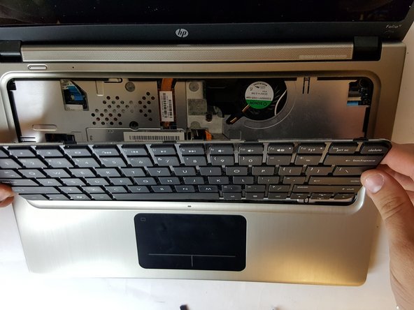

    • Using the flat portion of the plastic spudger, push the corner of the black surface until the first clip unlocks.
    • The top right corner of the keyboard should now be sticking out slightly.
    • Repeat the same process for the top left corner.

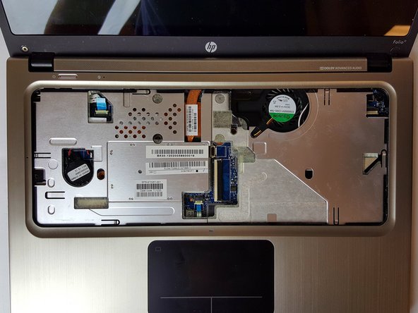

  4. HP Folio 13t-1000 RAM Replacement: crwdns2935265:04crwdnd2935265:01crwdnd2935265:02crwdne2935265:0 HP Folio 13t-1000 RAM Replacement: crwdns2935265:04crwdnd2935265:02crwdnd2935265:02crwdne2935265:0
    • Slide the keyboard up and towards the screen just enough to separate the keyboard from the top cover.
  5. HP Folio 13t-1000 RAM Replacement: crwdns2935265:05crwdnd2935265:01crwdnd2935265:03crwdne2935265:0 HP Folio 13t-1000 RAM Replacement: crwdns2935265:05crwdnd2935265:02crwdnd2935265:03crwdne2935265:0 HP Folio 13t-1000 RAM Replacement: crwdns2935265:05crwdnd2935265:03crwdnd2935265:03crwdne2935265:0

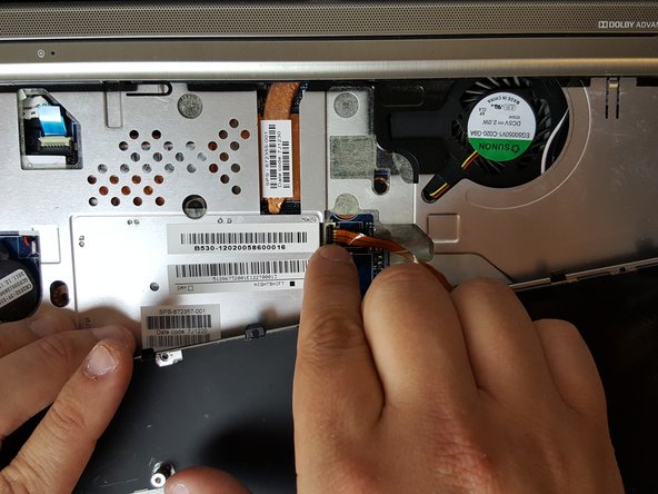

    • To unlock the clamps connected to the motherboard, use your fingers or insert the pointed edge of the spudger between the first clamp and the cable.
    • Repeat the same process for the second clamp.

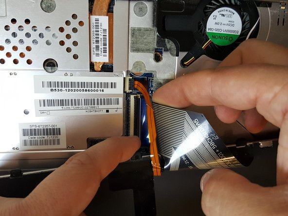

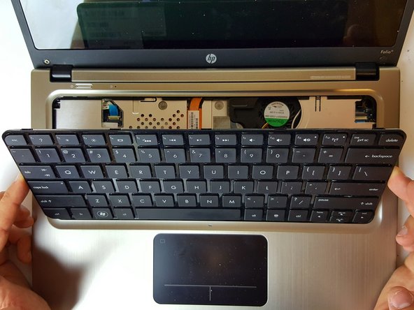

  6. HP Folio 13t-1000 RAM Replacement: crwdns2935265:06crwdnd2935265:01crwdnd2935265:03crwdne2935265:0 HP Folio 13t-1000 RAM Replacement: crwdns2935265:06crwdnd2935265:02crwdnd2935265:03crwdne2935265:0 HP Folio 13t-1000 RAM Replacement: crwdns2935265:06crwdnd2935265:03crwdnd2935265:03crwdne2935265:0
    • Remove the keyboard from the laptop.

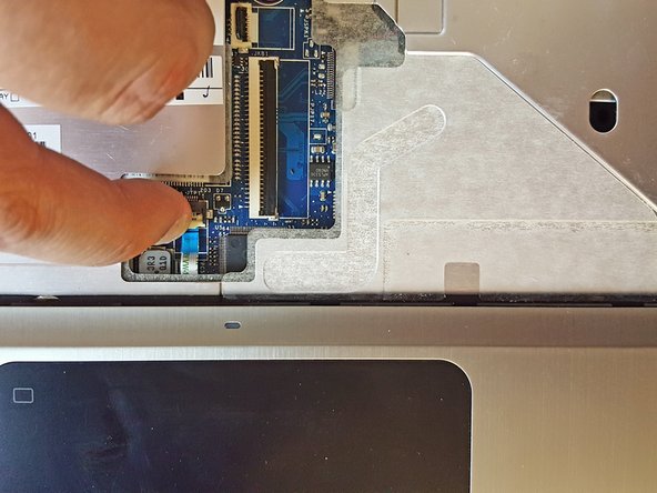

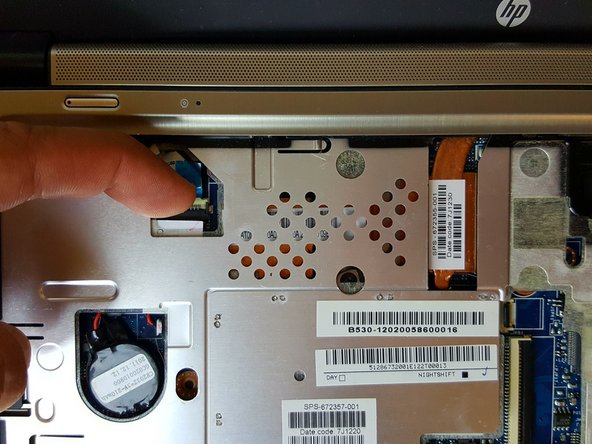

    • Place your finger between one of the plastic clamps and the cable and apply a slight leveraging force until the clamp pops up.
    • Do the same for the second connection.
