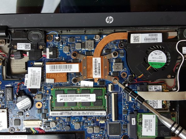

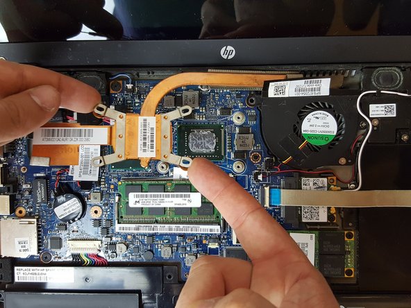

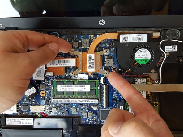

  9. HP Folio 13t-1000 Heatsink Replacement, Heat Sink: crwdns2935265:09crwdnd2935265:01crwdnd2935265:02crwdne2935265:0 HP Folio 13t-1000 Heatsink Replacement, Heat Sink: crwdns2935265:09crwdnd2935265:02crwdnd2935265:02crwdne2935265:0
    • Use a PH1 screw head to take out the four, 2mm screws.
  10. HP Folio 13t-1000 Heatsink Replacement: crwdns2935265:010crwdnd2935265:01crwdnd2935265:03crwdne2935265:0 HP Folio 13t-1000 Heatsink Replacement: crwdns2935265:010crwdnd2935265:02crwdnd2935265:03crwdne2935265:0 HP Folio 13t-1000 Heatsink Replacement: crwdns2935265:010crwdnd2935265:03crwdnd2935265:03crwdne2935265:0
    • Remove the heatsink with you fingers and replace it with a new heatsink.
