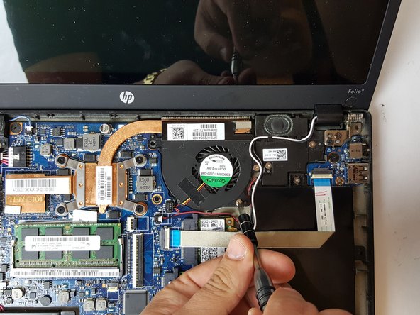

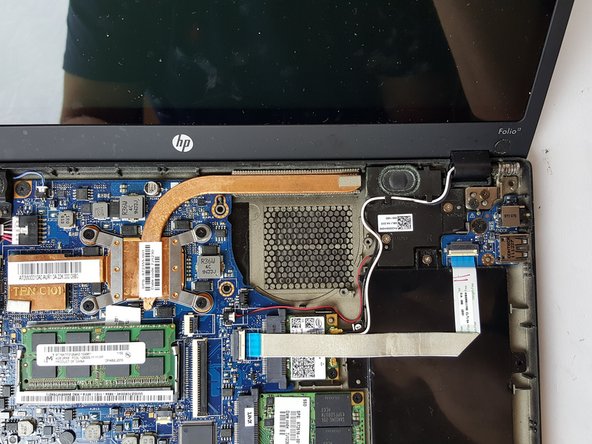

  9. HP Folio 13t-1000 Cooling Fan Replacement, Cooling Fan: crwdns2935265:09crwdnd2935265:01crwdnd2935265:02crwdne2935265:0 HP Folio 13t-1000 Cooling Fan Replacement, Cooling Fan: crwdns2935265:09crwdnd2935265:02crwdnd2935265:02crwdne2935265:0
    • Use a PH1 screw head to remove the two, 3mm screws.
  10. HP Folio 13t-1000 Cooling Fan Replacement: crwdns2935265:010crwdnd2935265:01crwdnd2935265:02crwdne2935265:0 HP Folio 13t-1000 Cooling Fan Replacement: crwdns2935265:010crwdnd2935265:02crwdnd2935265:02crwdne2935265:0
    • Remove the connection from the fan to the motherboard by using the nylon spudger or your fingers.
  11. HP Folio 13t-1000 Cooling Fan Replacement: crwdns2935265:011crwdnd2935265:01crwdnd2935265:02crwdne2935265:0 HP Folio 13t-1000 Cooling Fan Replacement: crwdns2935265:011crwdnd2935265:02crwdnd2935265:02crwdne2935265:0
    • Remove and replace the cooling fan.
