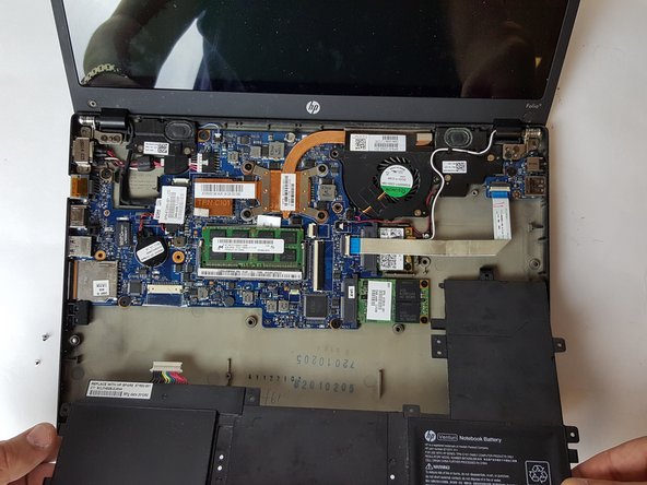

  9. HP Folio 13t-1000 Battery Replacement, Battery: crwdns2935265:09crwdnd2935265:01crwdnd2935265:02crwdne2935265:0 HP Folio 13t-1000 Battery Replacement, Battery: crwdns2935265:09crwdnd2935265:02crwdnd2935265:02crwdne2935265:0
    • Use a PH1 screw head to remove the two, 3mm screws.
  10. HP Folio 13t-1000 Battery Replacement: crwdns2935265:010crwdnd2935265:01crwdnd2935265:01crwdne2935265:0
    • Remove the motherboard connection using the nylon spudger or your fingers.
  11. HP Folio 13t-1000 Battery Replacement: crwdns2935265:011crwdnd2935265:01crwdnd2935265:01crwdne2935265:0
    • Separate the ribbon from the battery by wedging the flat metal spudger between the two.
  12. HP Folio 13t-1000 Battery Replacement: crwdns2935265:012crwdnd2935265:01crwdnd2935265:02crwdne2935265:0 HP Folio 13t-1000 Battery Replacement: crwdns2935265:012crwdnd2935265:02crwdnd2935265:02crwdne2935265:0
    • Remove old battery and replace with a new one.
