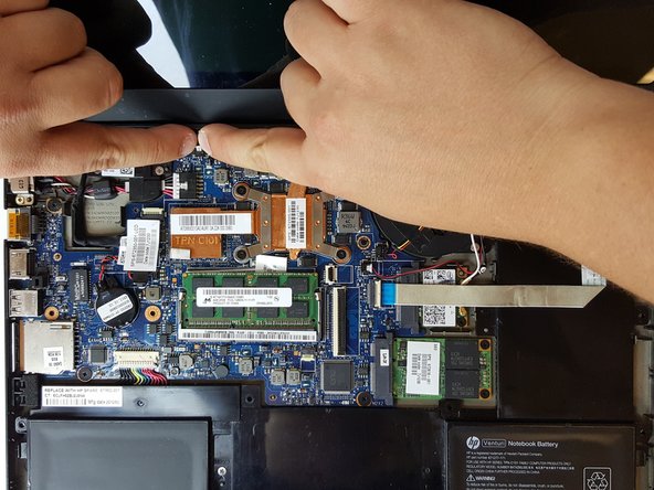

  6. HP Folio 13t-1000 Audio Speakers Replacement: crwdns2935265:06crwdnd2935265:01crwdnd2935265:03crwdne2935265:0 HP Folio 13t-1000 Audio Speakers Replacement: crwdns2935265:06crwdnd2935265:02crwdnd2935265:03crwdne2935265:0 HP Folio 13t-1000 Audio Speakers Replacement: crwdns2935265:06crwdnd2935265:03crwdnd2935265:03crwdne2935265:0
    • Remove the keyboard from the laptop.
  7. HP Folio 13t-1000 Audio Speakers Replacement, Top Hardware Cover: crwdns2935265:07crwdnd2935265:01crwdnd2935265:03crwdne2935265:0 HP Folio 13t-1000 Audio Speakers Replacement, Top Hardware Cover: crwdns2935265:07crwdnd2935265:02crwdnd2935265:03crwdne2935265:0 HP Folio 13t-1000 Audio Speakers Replacement, Top Hardware Cover: crwdns2935265:07crwdnd2935265:03crwdnd2935265:03crwdne2935265:0
    • Place your finger between one of the plastic clamps and the cable and apply a slight leveraging force until the clamp pops up.
    • Do the same for the second connection.
  8. HP Folio 13t-1000 Audio Speakers Replacement: crwdns2935265:08crwdnd2935265:01crwdnd2935265:02crwdne2935265:0 HP Folio 13t-1000 Audio Speakers Replacement: crwdns2935265:08crwdnd2935265:02crwdnd2935265:02crwdne2935265:0
    • Remove the top hardware cover.

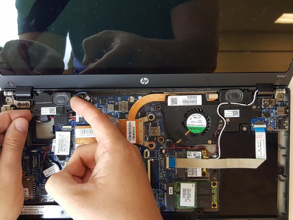

  9. HP Folio 13t-1000 Audio Speakers Replacement, Audio Speakers: crwdns2935265:09crwdnd2935265:01crwdnd2935265:01crwdne2935265:0
    • For the left speaker, use the PH1 screw head to remove the 2 screws.
  10. HP Folio 13t-1000 Audio Speakers Replacement: crwdns2935265:010crwdnd2935265:01crwdnd2935265:02crwdne2935265:0 HP Folio 13t-1000 Audio Speakers Replacement: crwdns2935265:010crwdnd2935265:02crwdnd2935265:02crwdne2935265:0
    • Carefully unplug the connection to the motherboard using your finger or the nylon spudger.
  11. HP Folio 13t-1000 Audio Speakers Replacement: crwdns2935265:011crwdnd2935265:01crwdnd2935265:03crwdne2935265:0 HP Folio 13t-1000 Audio Speakers Replacement: crwdns2935265:011crwdnd2935265:02crwdnd2935265:03crwdne2935265:0 HP Folio 13t-1000 Audio Speakers Replacement: crwdns2935265:011crwdnd2935265:03crwdnd2935265:03crwdne2935265:0
    • Carefully remove and replace the left speaker.

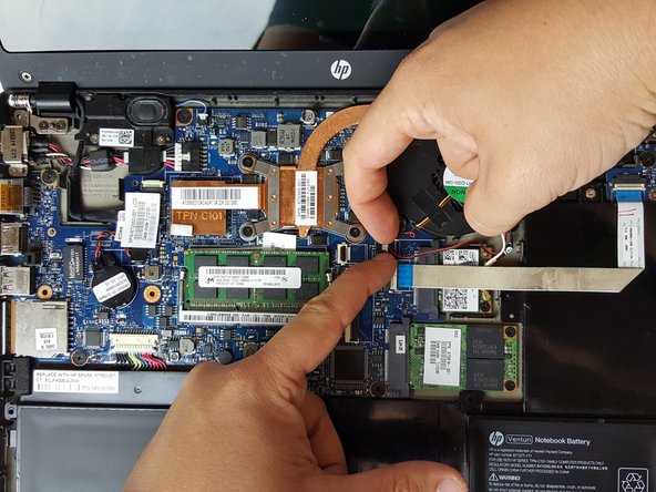

  13. HP Folio 13t-1000 Audio Speakers Replacement: crwdns2935265:013crwdnd2935265:01crwdnd2935265:01crwdne2935265:0
    • Move aside the black and white wires that are channeled through the top of the speaker housing using your fingers.
  14. HP Folio 13t-1000 Audio Speakers Replacement: crwdns2935265:014crwdnd2935265:01crwdnd2935265:02crwdne2935265:0 HP Folio 13t-1000 Audio Speakers Replacement: crwdns2935265:014crwdnd2935265:02crwdnd2935265:02crwdne2935265:0
    • Unplug the connection to the motherboard using your fingers or the nylon spudger.

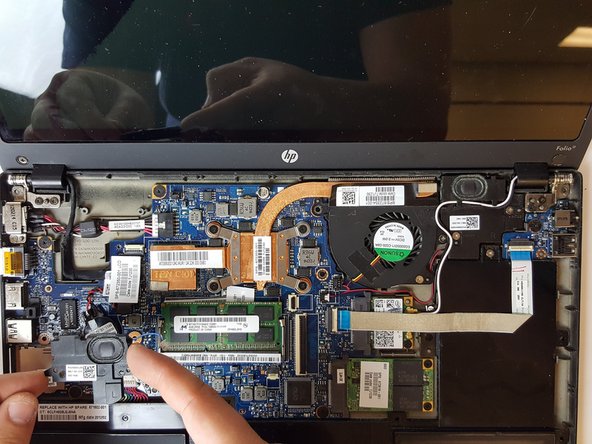

  15. HP Folio 13t-1000 Audio Speakers Replacement: crwdns2935265:015crwdnd2935265:01crwdnd2935265:01crwdne2935265:0
    • Carefully remove and replace the right speaker.
