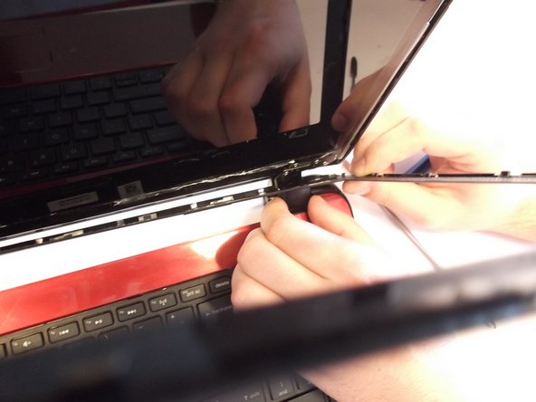

    1. HP Flyer Red Screen Replacement, Screen: crwdns2935265:05crwdnd2935265:01crwdnd2935265:01crwdne2935265:0
      • Flip over and open up the laptop with screen facing you.
    2. HP Flyer Red Screen Replacement: crwdns2935265:06crwdnd2935265:01crwdnd2935265:03crwdne2935265:0 HP Flyer Red Screen Replacement: crwdns2935265:06crwdnd2935265:02crwdnd2935265:03crwdne2935265:0 HP Flyer Red Screen Replacement: crwdns2935265:06crwdnd2935265:03crwdnd2935265:03crwdne2935265:0

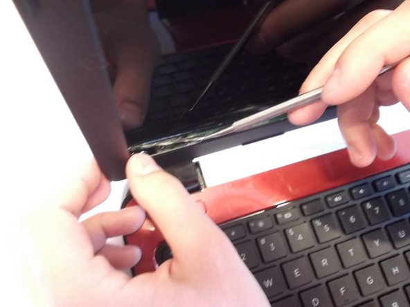

      • Slide plastic opening tool in crack at the top corner of the outer frame of the screen (in the gap between the red and black sections of plastic) and pry apart as shown.
      • Pry apart all edges the same as the top. Use the spudger for the bottom section as it is glued to tape, make sure to pry this apart carefully and the tape should be separated from the black plastic part as shown.
      • The glue is difficult to separate.
    3. HP Flyer Red Screen Replacement: crwdns2935265:07crwdnd2935265:01crwdnd2935265:02crwdne2935265:0 HP Flyer Red Screen Replacement: crwdns2935265:07crwdnd2935265:02crwdnd2935265:02crwdne2935265:0
      • Separate the black plastic frame from the body of the computer by sliding it up and towards you while rotating the top section away from you.
