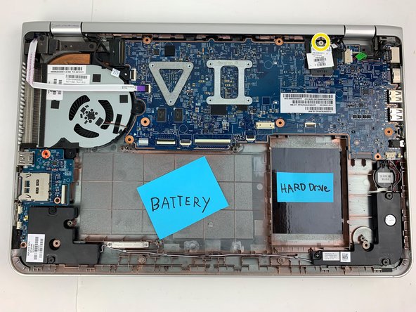

    • Make sure the laptop is powered off and disconnected from any outlets.
    • Use the opening pick to lift up the eight rubber grips on the underside of the device.
    • With the #1 Phillips screwdriver, remove the twelve 6mm screws from the back case.

  4. HP Envy x360 m6-w105dx RAM Replacement, RAM: crwdns2935265:04crwdnd2935265:01crwdnd2935265:03crwdne2935265:0 HP Envy x360 m6-w105dx RAM Replacement, RAM: crwdns2935265:04crwdnd2935265:02crwdnd2935265:03crwdne2935265:0 HP Envy x360 m6-w105dx RAM Replacement, RAM: crwdns2935265:04crwdnd2935265:03crwdnd2935265:03crwdne2935265:0
    • Gently open the ZIF connectors and remove the ribbon cables.
    • Unscrew the five 4mm screws with the Phillips #1 screwdriver.
    • Unscrew the WLAN chip and push the chip up and out of the port.

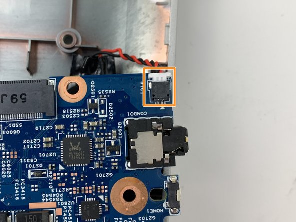

  5. HP Envy x360 m6-w105dx RAM Replacement: crwdns2935265:05crwdnd2935265:01crwdnd2935265:02crwdne2935265:0 HP Envy x360 m6-w105dx RAM Replacement: crwdns2935265:05crwdnd2935265:02crwdnd2935265:02crwdne2935265:0
    • Disconnect the cable connectors for the speakers.
    • Lift the motherboard up and flip towards you to disconnect an additional cable connector on the rear side.
    • Use an opening pick to pull the motherboard up on the fan side. Then pull the motherboard assembly out towards the left.

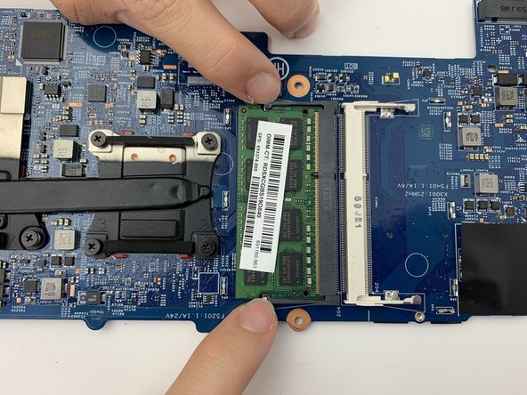

  7. HP Envy x360 m6-w105dx RAM Replacement: crwdns2935265:07crwdnd2935265:01crwdnd2935265:03crwdne2935265:0 HP Envy x360 m6-w105dx RAM Replacement: crwdns2935265:07crwdnd2935265:02crwdnd2935265:03crwdne2935265:0 HP Envy x360 m6-w105dx RAM Replacement: crwdns2935265:07crwdnd2935265:03crwdnd2935265:03crwdne2935265:0
    • Pull the metal retaining pins on either side of the RAM stick apart. The RAM stick will pop up.
    • Remove the RAM and insert a new one that is compatible.
    • Do not force the RAM stick or it will snap.
    • When doing a RAM replacement, make sure the correct chip is being used.
