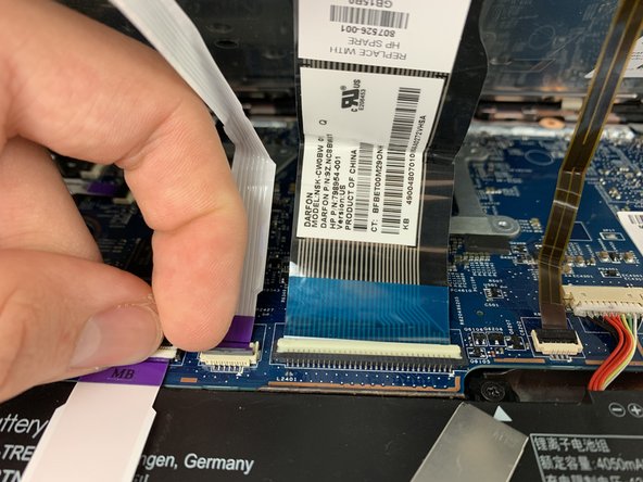

  3. HP Envy x360 m6-w105dx Keyboard Replacement: crwdns2935265:03crwdnd2935265:01crwdnd2935265:02crwdne2935265:0 HP Envy x360 m6-w105dx Keyboard Replacement: crwdns2935265:03crwdnd2935265:02crwdnd2935265:02crwdne2935265:0
    • Gently lift the keyboard up from the bottom.
    • Carefully open the locking flap of the three ZIF connectors and detach the three ribbon cables from the motherboard using your fingers.
    • Do not remove the ZIF connectors by pulling on the wires, instead detach them by gently flipping up the plastic tabs located at the ends of the wiring.
    • Fully remove the keyboard from the laptop and install your new keyboard.
