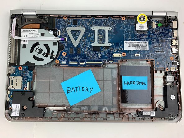

  4. HP Envy x360 m6-w105dx Fan Replacement, Fan: crwdns2935265:04crwdnd2935265:01crwdnd2935265:03crwdne2935265:0 HP Envy x360 m6-w105dx Fan Replacement, Fan: crwdns2935265:04crwdnd2935265:02crwdnd2935265:03crwdne2935265:0 HP Envy x360 m6-w105dx Fan Replacement, Fan: crwdns2935265:04crwdnd2935265:03crwdnd2935265:03crwdne2935265:0
    • Unscrew the five 4mm screws with the #01 phillips head screw driver.

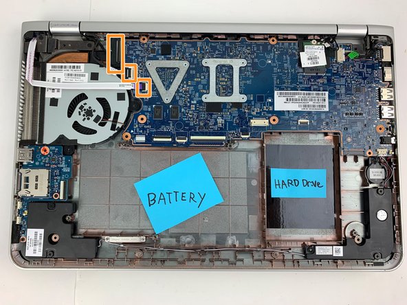

    • Gently flip open the ZIF connectors and remove the ribbon cables.
    • Unscrew the WLAN chip and push the chip up and out of the port.

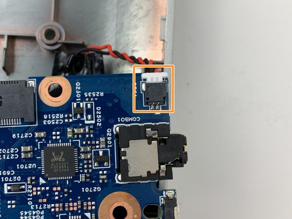

    • Disconnect the cable connectors for each of the speakers.

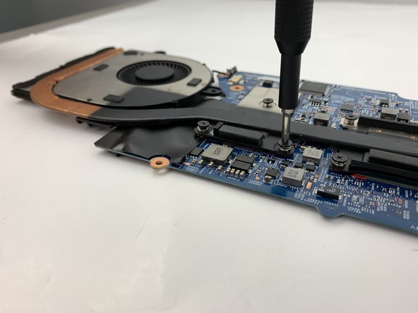

    • Unscrew the seven spring locked screws with the #1 Phillips screwdriver.

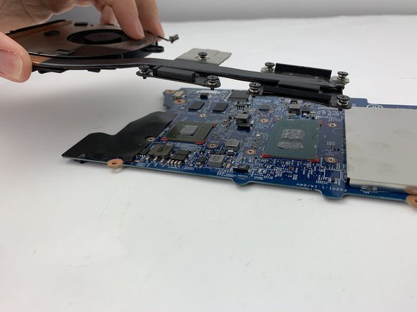

    • Once all screws are out, remove the fan by lifting it up from the motherboard.
