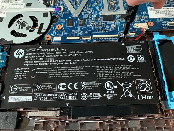

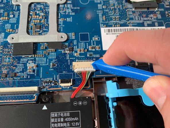

  4. HP Envy x360 m6-w105dx Battery Replacement, Battery: crwdns2935265:04crwdnd2935265:01crwdnd2935265:02crwdne2935265:0 HP Envy x360 m6-w105dx Battery Replacement, Battery: crwdns2935265:04crwdnd2935265:02crwdnd2935265:02crwdne2935265:0
    • Carefully flip up the locking tabs on the ZIF connectors and remove the ribbon cables from the connectors.
    • Disconnect the battery cable by sliding it downward from the connector with an iFixit opening tool.
    • Using this tool reduces the chance of any sparking or electronic charge.

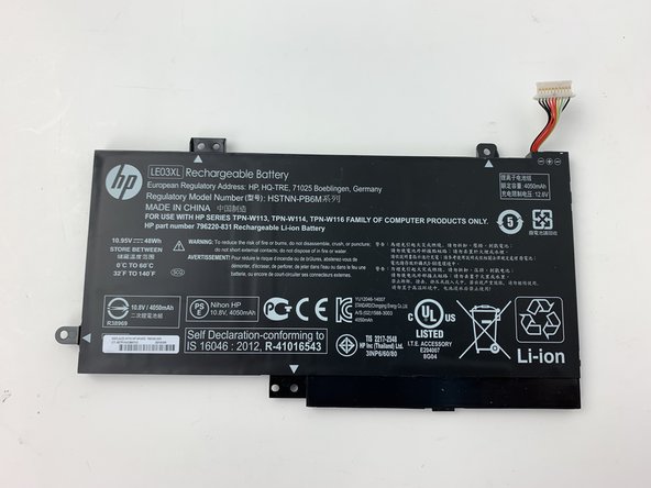

  5. HP Envy x360 m6-w105dx Battery Replacement: crwdns2935265:05crwdnd2935265:01crwdnd2935265:02crwdne2935265:0 HP Envy x360 m6-w105dx Battery Replacement: crwdns2935265:05crwdnd2935265:02crwdnd2935265:02crwdne2935265:0
    • Using the Phillips #1 screwdriver, unscrew the four 6 mm screws.
  6. HP Envy x360 m6-w105dx Battery Replacement: crwdns2935265:06crwdnd2935265:01crwdnd2935265:02crwdne2935265:0 HP Envy x360 m6-w105dx Battery Replacement: crwdns2935265:06crwdnd2935265:02crwdnd2935265:02crwdne2935265:0
    • Gently lift the battery up from the case and replace it.
