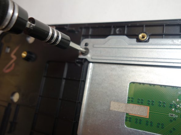

  8. HP Envy x360 m6-w103dx Touchpad Replacement, Touchpad: crwdns2935265:08crwdnd2935265:01crwdnd2935265:02crwdne2935265:0 HP Envy x360 m6-w103dx Touchpad Replacement, Touchpad: crwdns2935265:08crwdnd2935265:02crwdnd2935265:02crwdne2935265:0
    • Remove the five screws from the touchpad using a Phillips #0 screwdriver.
  9. HP Envy x360 m6-w103dx Touchpad Replacement: crwdns2935265:09crwdnd2935265:01crwdnd2935265:01crwdne2935265:0
    • Remove the metal bar holding the touchpad in place.
  10. HP Envy x360 m6-w103dx Touchpad Replacement: crwdns2935265:010crwdnd2935265:01crwdnd2935265:01crwdne2935265:0
    • Remove the touchpad from the laptop.
