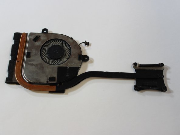

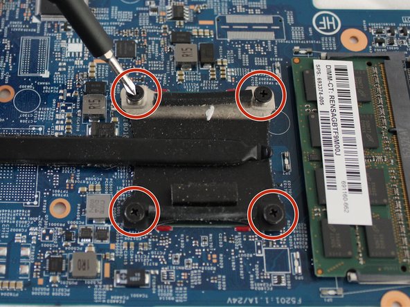

  8. HP Envy x360 m6-w103dx Fan Replacement, Fan: crwdns2935265:08crwdnd2935265:01crwdnd2935265:02crwdne2935265:0 HP Envy x360 m6-w103dx Fan Replacement, Fan: crwdns2935265:08crwdnd2935265:02crwdnd2935265:02crwdne2935265:0
    • Carefully lay the motherboard on a flat surface with the metal plate facing up.
    • Unscrew the four 6.0 mm screws from the heatsink using a #00 Phillips screwdriver.
    • The screws do not detach from the component, just the motherboard.

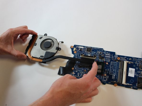

  9. HP Envy x360 m6-w103dx Fan Replacement: crwdns2935265:09crwdnd2935265:01crwdnd2935265:01crwdne2935265:0
    • Disconnect the fan pin-head connector.
  10. HP Envy x360 m6-w103dx Fan Replacement: crwdns2935265:010crwdnd2935265:01crwdnd2935265:03crwdne2935265:0 HP Envy x360 m6-w103dx Fan Replacement: crwdns2935265:010crwdnd2935265:02crwdnd2935265:03crwdne2935265:0 HP Envy x360 m6-w103dx Fan Replacement: crwdns2935265:010crwdnd2935265:03crwdnd2935265:03crwdne2935265:0
    • Carefully lift the fan assembly and pull away from the motherboard.
    • When reassembling, be sure to clean the old thermal paste from the heatsink and CPU contact points. Then, reapply new thermal paste with our How to Apply Thermal Paste guide.
