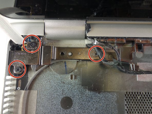

  8. HP Envy x360 m6-w103dx Display Replacement, Display: crwdns2935265:08crwdnd2935265:01crwdnd2935265:02crwdne2935265:0 HP Envy x360 m6-w103dx Display Replacement, Display: crwdns2935265:08crwdnd2935265:02crwdnd2935265:02crwdne2935265:0
    • Remove the six 6 mm screws from the hinges with a Phillips #0 screwdriver.
