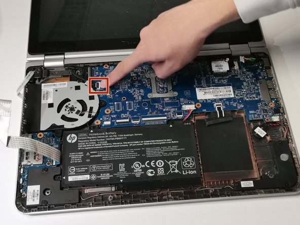

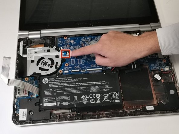

    • Lift the keyboard and locate the Motherboard
  2. HP Envy x360 m6-w 101dx Motherboard Replacement: crwdns2935265:02crwdnd2935265:01crwdnd2935265:02crwdne2935265:0 HP Envy x360 m6-w 101dx Motherboard Replacement: crwdns2935265:02crwdnd2935265:02crwdnd2935265:02crwdne2935265:0
    • Once located, Disconnect all the cables you see connected to the Motherboard.
    • photos indicate disconnecting the CPU, Battery from the motherboard.
  3. HP Envy x360 m6-w 101dx Motherboard Replacement: crwdns2935265:03crwdnd2935265:01crwdnd2935265:03crwdne2935265:0 HP Envy x360 m6-w 101dx Motherboard Replacement: crwdns2935265:03crwdnd2935265:02crwdnd2935265:03crwdne2935265:0 HP Envy x360 m6-w 101dx Motherboard Replacement: crwdns2935265:03crwdnd2935265:03crwdnd2935265:03crwdne2935265:0
    • Continue disconnecting the cables associated with motherboard
    • Photos indicate the SD card, screen and fan have all been disconnected from the motherboard.
