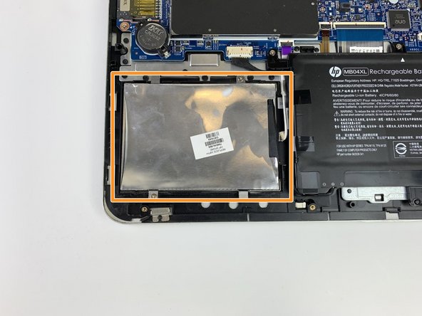

    • Ground yourself by touching a metal object or surface. This prevents electrical damage to other components in the laptop.
    • Remove the two 7.8 mm screws using the Phillips #0 screwdriver.
    • Remove the six 5.2 mm screws using the Torx T5 screwdriver.
  2. HP Envy x360 m6-aq105dx Solid State Drive Replacement: crwdns2935265:02crwdnd2935265:01crwdnd2935265:01crwdne2935265:0
    • Light to moderate force is required to remove the back cover.
    • Insert the Jimmy in between the frame of the laptop and the removable back cover and remove the back cover from the device.
  3. HP Envy x360 m6-aq105dx Solid State Drive Replacement, Solid State Drive: crwdns2935265:03crwdnd2935265:01crwdnd2935265:01crwdne2935265:0
    • Remove the two 4.6 mm screws securing old hard drive/solid-state drive in place using the Phillips #0 screwdriver.
  4. HP Envy x360 m6-aq105dx Solid State Drive Replacement: crwdns2935265:04crwdnd2935265:01crwdnd2935265:02crwdne2935265:0 HP Envy x360 m6-aq105dx Solid State Drive Replacement: crwdns2935265:04crwdnd2935265:02crwdnd2935265:02crwdne2935265:0
    • Disconnect the SATA cable connected to the old hard drive/solid-state drive.
    • Remove the solid state drive.
