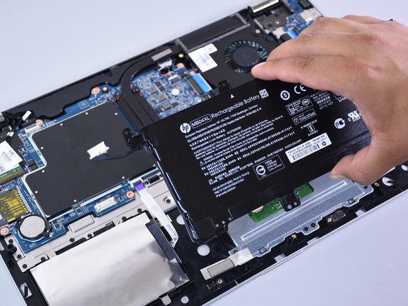

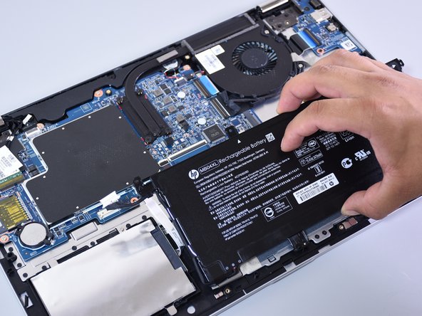

  7. HP Envy x360 m6-aq103dx Wireless Module Replacement: crwdns2935265:07crwdnd2935265:01crwdnd2935265:03crwdne2935265:0 HP Envy x360 m6-aq103dx Wireless Module Replacement: crwdns2935265:07crwdnd2935265:02crwdnd2935265:03crwdne2935265:0 HP Envy x360 m6-aq103dx Wireless Module Replacement: crwdns2935265:07crwdnd2935265:03crwdnd2935265:03crwdne2935265:0
    • Lift the battery out of the laptop with your hands.

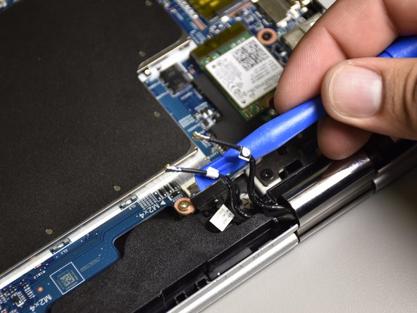

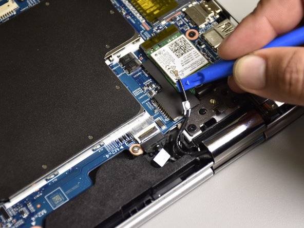

  8. HP Envy x360 m6-aq103dx Wireless Module Replacement, Intel Wireless Module: crwdns2935265:08crwdnd2935265:01crwdnd2935265:03crwdne2935265:0 HP Envy x360 m6-aq103dx Wireless Module Replacement, Intel Wireless Module: crwdns2935265:08crwdnd2935265:02crwdnd2935265:03crwdne2935265:0 HP Envy x360 m6-aq103dx Wireless Module Replacement, Intel Wireless Module: crwdns2935265:08crwdnd2935265:03crwdnd2935265:03crwdne2935265:0
    • Remove the two antenna cables connected to the wireless module by wedging the small plastic opening tool between the cables and the wireless module and lifting up.

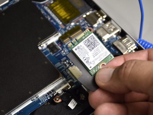

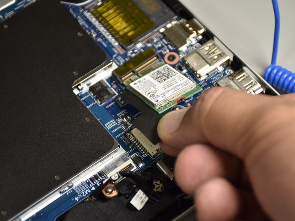

  10. HP Envy x360 m6-aq103dx Wireless Module Replacement: crwdns2935265:010crwdnd2935265:01crwdnd2935265:03crwdne2935265:0 HP Envy x360 m6-aq103dx Wireless Module Replacement: crwdns2935265:010crwdnd2935265:02crwdnd2935265:03crwdne2935265:0 HP Envy x360 m6-aq103dx Wireless Module Replacement: crwdns2935265:010crwdnd2935265:03crwdnd2935265:03crwdne2935265:0
    • Slide the wireless module towards the back of the computer to remove it.
