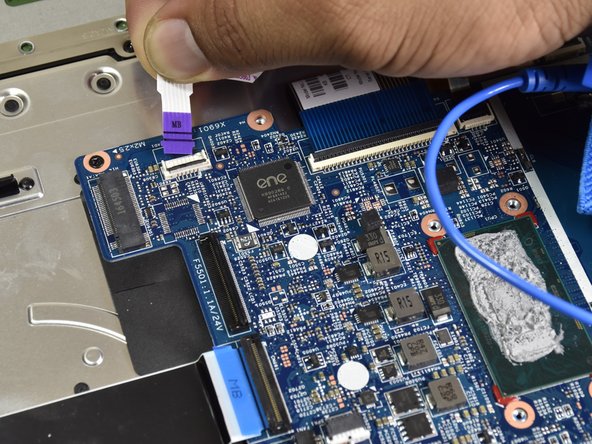

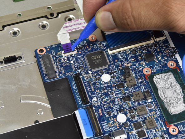

    • Use the small plastic opening tool to disconnect the port attached to the white ribbon cable with purple tips.
    • Press the tool to the top of the tip of the cable and pull it outwards.
    • Press the tool to the side of the tip of the cable and slide it outwards.
    • Use your hand to lift the cable up and out of the way.

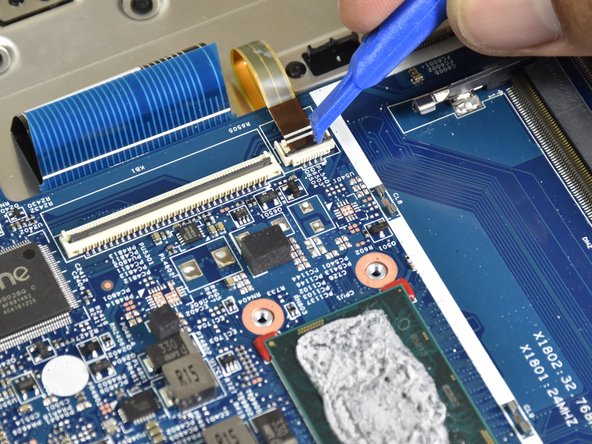

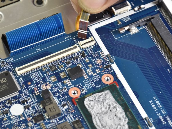

  21. HP Envy x360 m6-aq103dx Motherboard Replacement: crwdns2935265:021crwdnd2935265:01crwdnd2935265:03crwdne2935265:0 HP Envy x360 m6-aq103dx Motherboard Replacement: crwdns2935265:021crwdnd2935265:02crwdnd2935265:03crwdne2935265:0 HP Envy x360 m6-aq103dx Motherboard Replacement: crwdns2935265:021crwdnd2935265:03crwdnd2935265:03crwdne2935265:0
    • Use the small plastic opening tool to disconnect the port attached to the golden brown ribbon cable with the yellow underside.

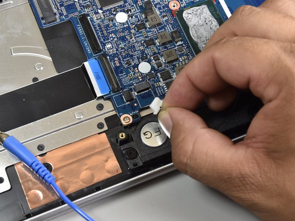

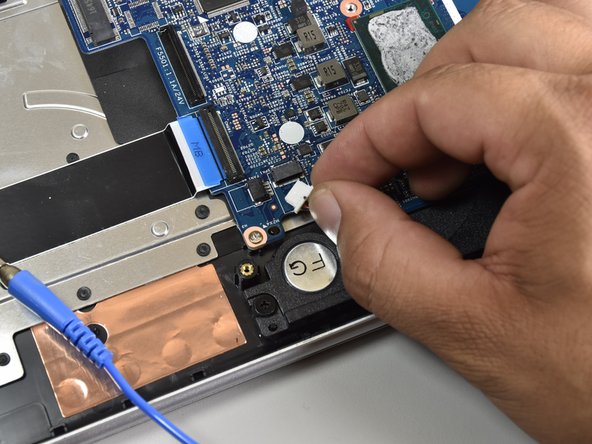

  22. HP Envy x360 m6-aq103dx Motherboard Replacement: crwdns2935265:022crwdnd2935265:01crwdnd2935265:03crwdne2935265:0 HP Envy x360 m6-aq103dx Motherboard Replacement: crwdns2935265:022crwdnd2935265:02crwdnd2935265:03crwdne2935265:0 HP Envy x360 m6-aq103dx Motherboard Replacement: crwdns2935265:022crwdnd2935265:03crwdnd2935265:03crwdne2935265:0
    • Remove the clear tape near the charging port with your hand in order to flip the tab up with the small plastic opening tool.
